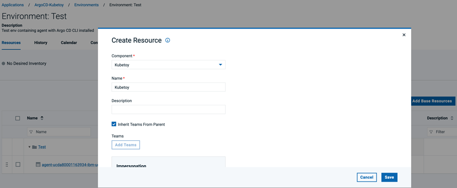

Create an environment in the new DevOps Deploy application. Add the DevOps Deploy agent where you previously installed the Argo CD CLI to the resource tree of this new DevOps Deploy environment.
Create DevOps Deploy Component
Create a new DevOps Deploy component, using the ArgoCD Component Template. Fill in the required component properties, including argocd.server, argocd.user, argocd.password, and argocd.application.name. Specify any required Argo CD CLI global flags in the argocd.global.flags field, such as --config=../argocd.config --insecure. Be sure to specify each global flag on a line of its own. If the Argo CD CLI is not installed in a directory that is included in the PATH of the agent, specify its location in argocd.cmd.path.
Once the new DevOps Deploy component has been created, add it to the new DevOps Deploy application. Also add a reference to the new component under the DevOps Deploy agent in the DevOps Deploy application environment resource tree.
