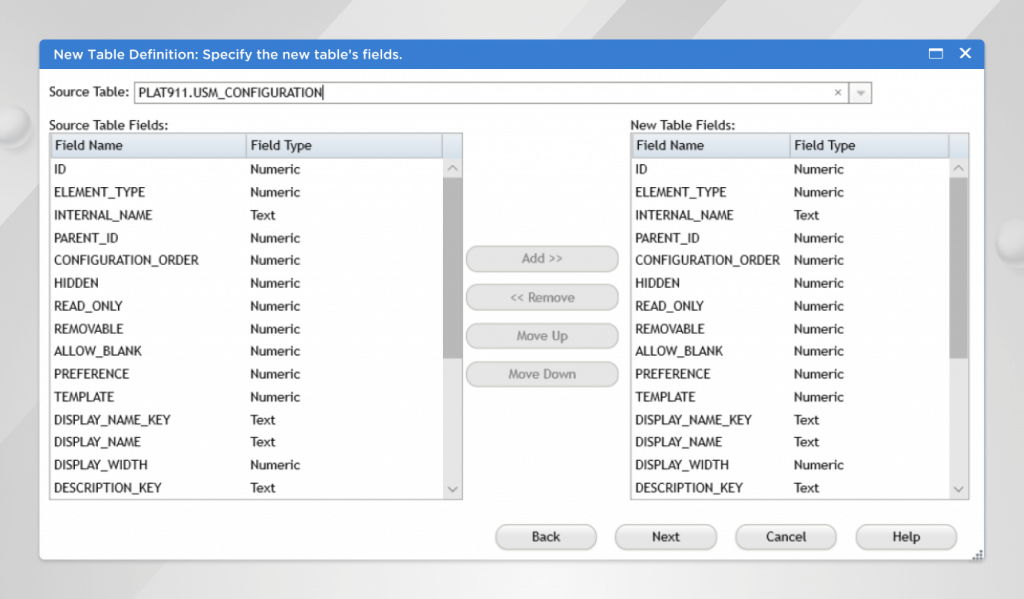

3.2 Select 1 Platform Table from DB2 and click Next
Unica Campaign Platform Table
