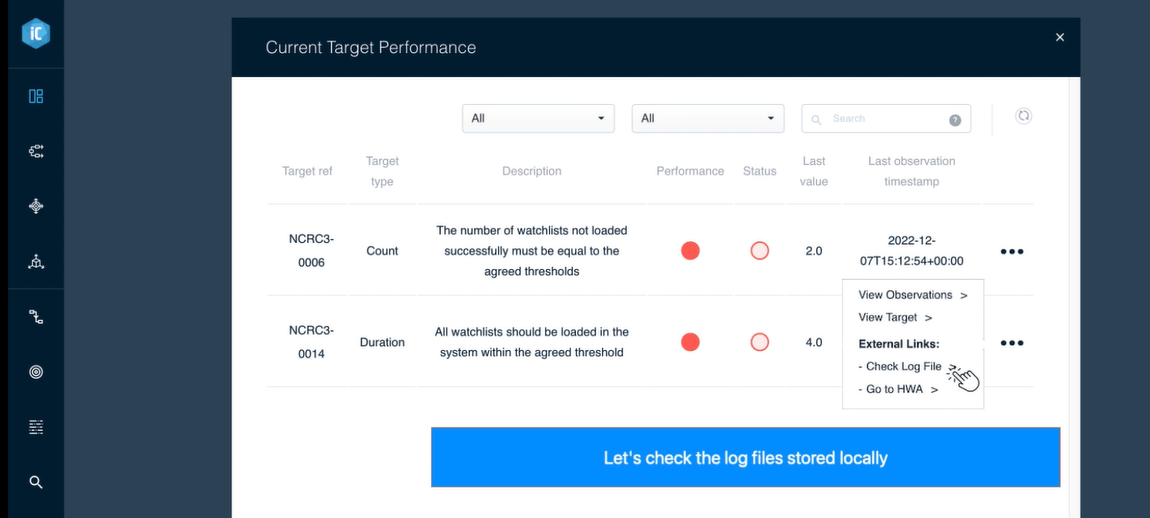

[09/09/22 16:12:09:600 ICT] [ERROR] [pool-3-thread-3] riodicNotificationService – Error org.springframework.jdbc.CannotGetJdbcConnectionException: Could not get JDBC Connection; nested exception is org.apache.tomcat.dbcp.dbcp.SQLNestedException: Cannot get a connection, pool exhausted
HWA+iControl
Associated KPIs on iControl Side :
  • “The number of watchlists not loaded successfully must be equal to the Agreed thresholds”
  • “All watchlists should be loaded in the System within the Agreed Threshold”
So the business becomes aware of the associated KPIs affected, given the long-running job.
HWA+iControl
Recovery:
An event rule named CONNPOOL_EXTEND is defined, which would execute when the Load Watchlists job goes beyond the max duration, which in turn executes the recovery action to extend the connection pool—and accommodates more connections:
HWA+iControl
Next the CARRYOUT_SCREENING job is executed at around 08:39pm and completes by 08:41pm IST.
This completes the whole AML chain within the SLA, with every step tracked closely for Business KPIs, as well as individual steps within HWA.
