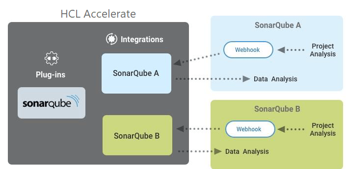

1. Webhook Pattern
HCL Accelerate uses a webhook pattern to integrate with SonarQube. A webhook is used to notify HCL Accelerate whenever a project analysis has finished, and HCL Accelerate then retrieves additional information from SonarQube about the analysis. Each integration creates its own HCL Accelerate endpoint to be used by SonarQube as a webhook URL. It is possible to configure multiple SonarQube integrations in this way, or to configure multiple SonarQube instances to webhook a single integration. This depends on your needs.

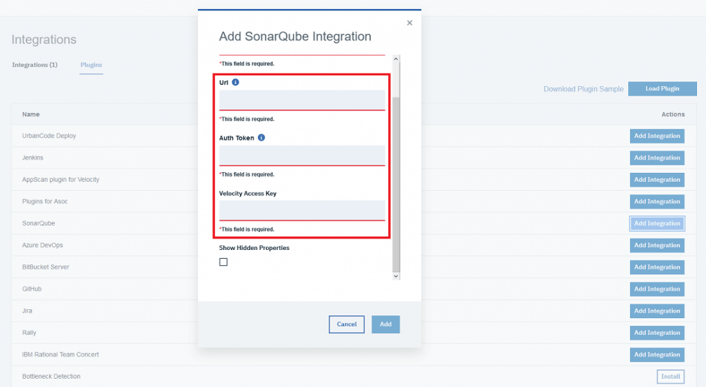

Create a SonarQube integration in HCL Accelerate. Go to “Settings” > “Integrations”, under the “Plugins” tab, click “Add Integration” for the SonarQube plugin. Provide all required fields.
NOTE: After creating the iteration, check to see if an update is available. It’s a good idea to update integrations to the latest version.
- Integration Name
- SonarQube URL
- SonarQube Auth Token You should be able to create a SonarQube auth token in SonarQube from User > My Account > Security (SonarQube documentation).
- HCL Accelerate User Access Key To create an access key, go to “Settings” > “My profile” and click “Create”. It’s a good idea to name your access key according to the integration that will use it. Make sure to copy the key at this point, since you will not be able to copy it later.
