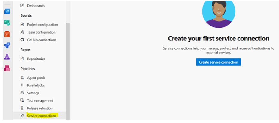

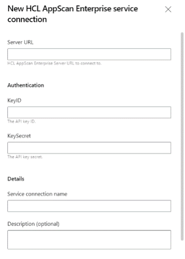

Once the extension is installed, it needs to be configured with AppScan Enterprise (ASE) credentials with theKeyID and using the Service Connection in Azure DevOps.
Enter the ASE Server URL (format of the URL is like https://<hostname>:<port>/ase) , provide the key and secret. Follow this link to generate keyId and Secret in the ASE

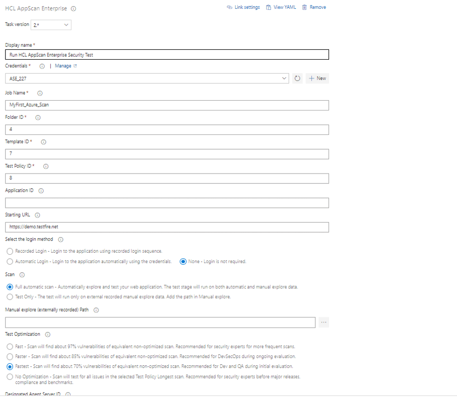

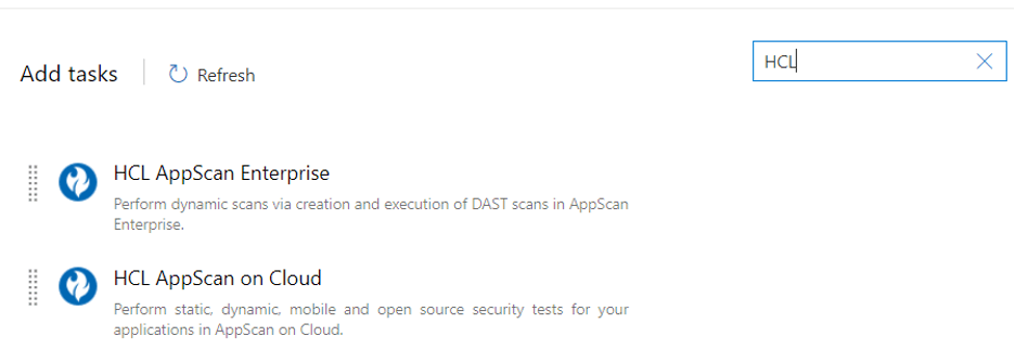

Create a new pipeline and add a task of type HCL AppScan Enterprise as shown below.
Enter the relevant details for the added task in the pipeline. We can get folder ID, Template ID, Test Policy ID and Application ID using the ASE REST APIs. The “Starting URL” field is the URL of the application to be security scanned. A sample of the same is as shown below.

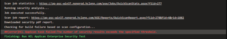

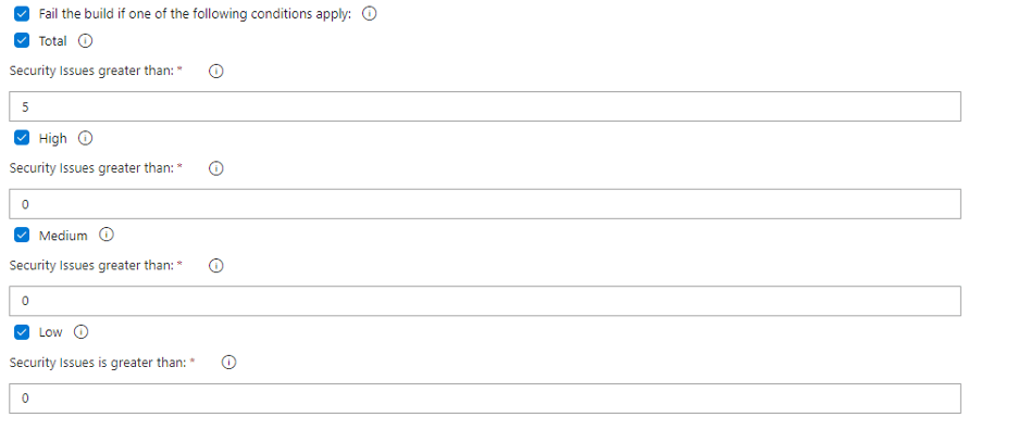

- We can configure the build to fail based on the security results. As an example, we can fail the build if the number of high security vulnerabilities is more than 5.
Configuration can be made as shown below.
In case the above conditions are met, Azure build fails and we get the appropriate message in Azure console. Sample console message is as shown below.

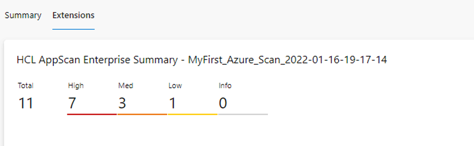

8. The Build Summary infodisplays the issue count based on severity once the scan completes successfully.
