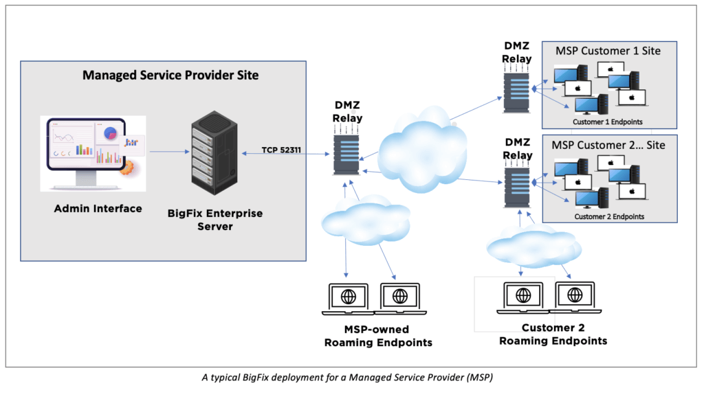

Overall Architecture
BigFix is typically installed in a centralized architecture like the one shown below. BigFix can manage thousands of separate customer environments – each with thousands of managed endpoints – without requiring a VPN connection to each client by leveraging BigFix relays. A BigFix relay is any managed endpoint with additional responsibilities that can also work as a distribution point. BigFix can also manage ‘roaming’ endpoints at home, offices, hotels, and cafes.
A single BigFix Enterprise Server at the MSP’s central site can manage up to 300,000 endpoints.
overall architecture
Top Level Relays (MSP Relays)
To manage customer endpoints, the MSP needs to separate the BigFix server from the public internet via one or more relays. Multiple top-level relays may be required over time as extra capacity dictates. Each top-level relay can support up to 1000 child relays, where each child relay is responsible for communicating back to the BigFix Server at the MSP. As a result, one top-level relay could support up to 1000 MSP-managed customers.
A second top-level relay is recommended for redundancy. With two top-level relays, an MSP could support up to 2000 child relays (or managed customers).
Client Relays (Customer Relays)
At each customer office managed by the MSP, it is recommended to install a BigFix Client Relay in their DMZ. By doing so, you avoid unnecessary traffic and greater bandwidth requirements due to each endpoint communicating back to the top-level relays.
A BigFix Client Relay can be installed on any existing server running Windows, Linux or UNIX already located in the DMZ. The Client Relay in the DMZ is simply a BigFix Agent configured to communicate back to a top-level relay. DMZ relays act as an intermediary to ensure secure transit of communication inbound and outbound from the BigFix Enterprise Server. If the Child Relay is a dedicated system, it can support up to 5000 managed endpoints.
