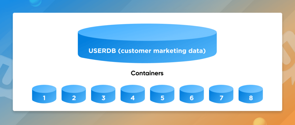

Example 1: User database
During performance testing, disk utilization on the User Database machine pertaining to I/O is observed to go up to 100%. The database has a tablespace with containers spanned over two disks. After tuning and spreading containers over a total of 8 disks, in certain cases, you may still see spikes, but the average consumption is brought below 20% while running 5 concurrent complex flowcharts.

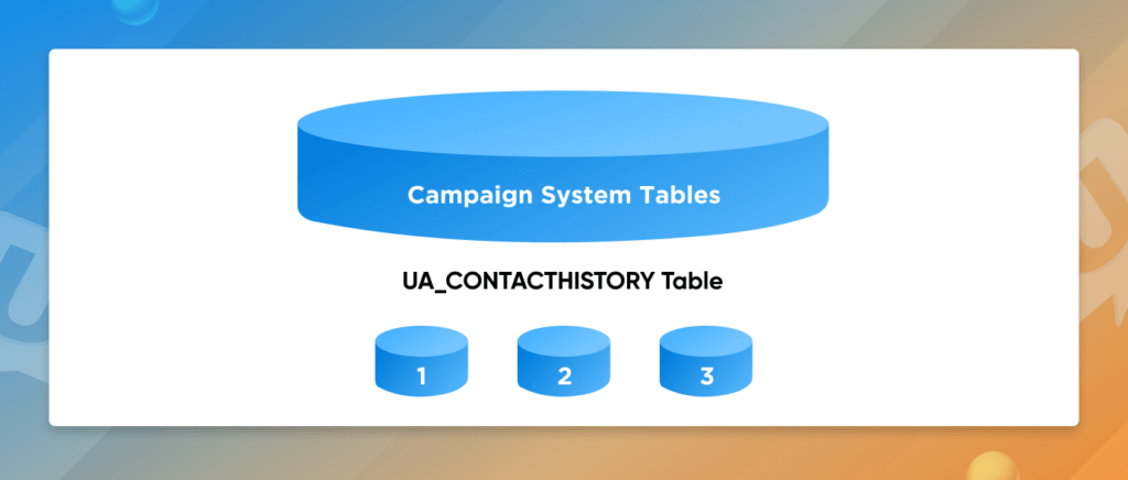

Example 2: System database server
There is a possibility of Disk I/O contention on the Unica Campaign System database server as well. Depending on your flowchart, a large amount of data may be written to the UA_CONTACTHISTORY table. For example, say you are running five multiple concurrent complex flowcharts, which are writing a large amount of data to UA_CONTACTHISTORY simultaneously. In this case, spreading database table spaces across multiple disks can improve performance.

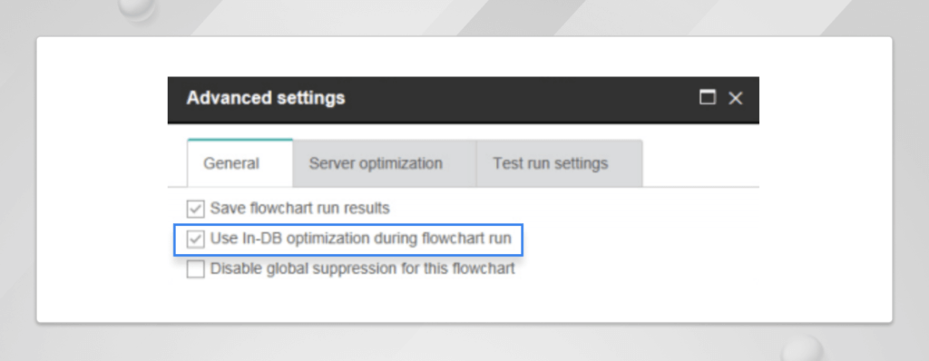

c. Set useInDbOptimization to TRUE (on) or FALSE (off). - To override the option for an individual flowchart:a. Open a flowchart in Edit mode.
b. Open the Admin menu and select Advanced settings.
c. Select or clear Use In-DB optimization during flowchart run.
When you save and run the flowchart, in-database processing will be used whenever possible if you are using in-database optimization.
