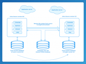

How to Fast Upgrade from Unica V8.6x to V12.1
Prerequisite
  1. Before upgrading, make sure you have your based version (i.e. 8.6.x) up and fully functional.
  2. Fresh version of 12.1 is installed on different machine with same Database type as of source Unica version.
  3. Make sure fresh version 12.1 is fully configured and is up and running.
  4. Take a back of Platform, Campaign, Interact Design Time, Interact Runtime, Learning DB, Profile DB, Plan system DB of source version 8.6.x
  5. Restore database(schema) backup taken in step (d) above in the relevant database of the target environment.

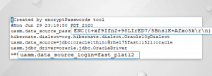

If you are using new schema then navigate to <PLATFORM_HOME>/tools/bin and update the file jdbc.properties with below details.
  • Run the below command and copy the encrypted password in the jdbc.properties file ./encryptPasswords.sh –d <PLATFORM_DB_USER_PASSWORD>
  • Update the Platform user name in the User Name field.
2. If you see ‘\’ character in the uasm.data_source then remove the additional ‘\’ character.

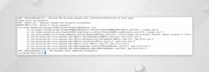

4. Execute the following command to upgrade Unica Platform configurations to 12.1.0. Navigate to <PLATFORM_HOME>/tools/bin location and execute below command.
  • ./configTool.sh –vp -p “Affinium” -f “<PLATFORM_HOME>/conf/Manager_config.xml”
  • ./populateDb.sh -n Manager

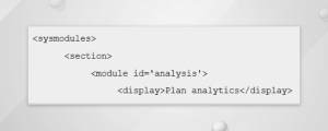

  • ./configTool.sh –vp -p “Affinium|suite|uiNavigation|mainMenu|Analytics” -f “<PLATFORM_HOME>/conf/watsonAssistant_navigation.xml”
  • ./alertConfigTool.sh –i -f “<PLATFORM_HOME>/conf/Platform_alerts_configuration.xml”
  • ./configTool.sh –vp -p “Affinium|Report|integrations” -f “<PLATFORM_HOME>/conf/upgrade101to11/cognos11_integration.xml”
  • ./upgrade86to90.sh (Only if you source version is 8.6)
  • ./upgrade90to91.sh (Only if you source version is either 8.6 or 9.0)
  • ./quartzjobtool.sh

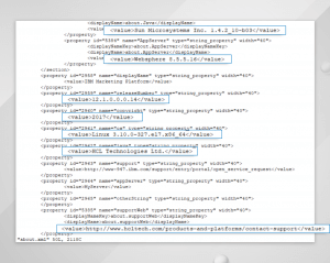

  • ./configTool.sh -x -p “Affinium|Manager|about” -f “<PLATFORM_HOME> /conf/about.xml”
Edit the about.xml file generated by the above command. Change the version and other details as below.
<property id=”xxxxxx” name=”releaseNumber” type=”string_property” width=”40″> <value>12.0.0.0.0.16</value> </property>
Import the updated about.xml in the Platform configuration using below command.
./configTool.sh -v –i -o -p “Affinium|Manager” -f <UNICA_PLATFORM_HOME>/Platform/conf/about.xml

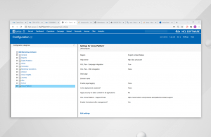

5. Change the application navigation URL from the USM_CONFIGURATION_VALUES table using below query. Take the back of USM_CONFIGURATION_VALUES table before running the query.
UPDATE USM_CONFIGURATION_VALUES SET string_value = REPLACE(string_value, ‘<OLD HOSTNAME.DOMAIN>’, ‘<NEW_HOSTNAME.DOMAIN>’) WHERE string_value like ‘%http%’;

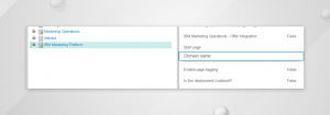

6. The URL of the start page that appears when each user log in to HCL Unica products has to be changed manually from the USM_PERSONALIZATION table

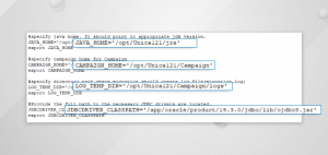

2. Navigate to CAMPAIGN_HOME /tools/upgrade/11.1+To12.1and edit the setenv.sh file for below mentioned attributes.
  • Edit the username if installation user is not root.
  • Update JAVA_HOME parameter to <UNICA_HOME>/jre location.
  • Update CAMPAIGN_HOME to actual Campaign directory.
  • Updates LOG_TEMP_DIR to <CAMPAIGN_HOME>/logs
  • Update JDBCDRIVER_CLASSPATH to your directory were driver is located.
  • Add the JVM Option JAVA_OPTIONS=”${JAVA_OPTIONS} -DFAST_UPGRADE_VERSION=8.6.x

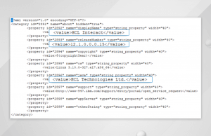

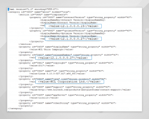

./configTool.sh -x -p “Affinium|Campaign|about” -f <PLATFORM_HOME>/conf/campaign_about.xml
5. Edit the campaign_about.xml. Change the below properties in the campaign_about.xml file as highlighted.
6. Navigate to <PLATFORM_HOME/tools/bin location and run the below command
./configTool.sh -v –i -o -p “Affinium|Campaign” -f <PLATFORM_HOME>/conf/campaign_about.xml

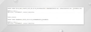

 5. Navigate to <CAMPAIGN_HOME>/ddl and execute the script aco_extra_indexes_<db>.sql
Before you execute the script verify if you have defined custom audience level and not using default audience level. If yes then you will get below error on executing the script aco_extra_indexes_<db>.sql
Update the script aco_extra_indexes_<db>.sql with actual audience id that you are using before running the script.

  • ./configTool.sh -x -p “Affinium|Interact|about” -f Interact_about.xml
  • Update the below highlighted variable in the Interact_about.xml
  • ./configTool.sh -v -o –i -p “Affinium|Interact” -f Interact_about.xml

6. In Plan_HOME/conf/en_US/sysmodules.xml (where en_US is the locale), change the value of <display> to Plan.

20. Now login to the application and navigate to SetingsàConfigurationàPlanàumoConfiguration.
Update below locations.
  • templates
  • attachmentFolders
  • integrationServices

./configTool.sh -x -p “Affinium|Plan|about” -f <PLATFORM_HOME>/conf/plan_about.xml
25. Edit the plan_about.xml file to update the version details, displayName and copy right information.
26. Run the below command to import the plan_about.xml changes.
./configTool.sh -v i -o -p Affinium|Plan -f <PLATFORM_HOME>/conf/plan_about.xml

1. Issue : While running the script aco_extra_indexes_<db>.sql you may encounter the below error if you have added the custom audience level.
Solution : Update the aco_extra_indexes_<db>.sql script to include the audience id of the custom audience level replacing the default audience id.

4. Issue : Not able to access platform page even changing all the URL’s to the target URL. This case can happen when the domain name of the source and target server is different.
Solution : Change the “Domain name” parameter under Configuration of Marketing Platform if it is pointing to the source domain.
