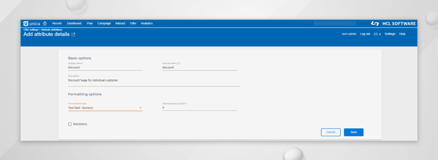

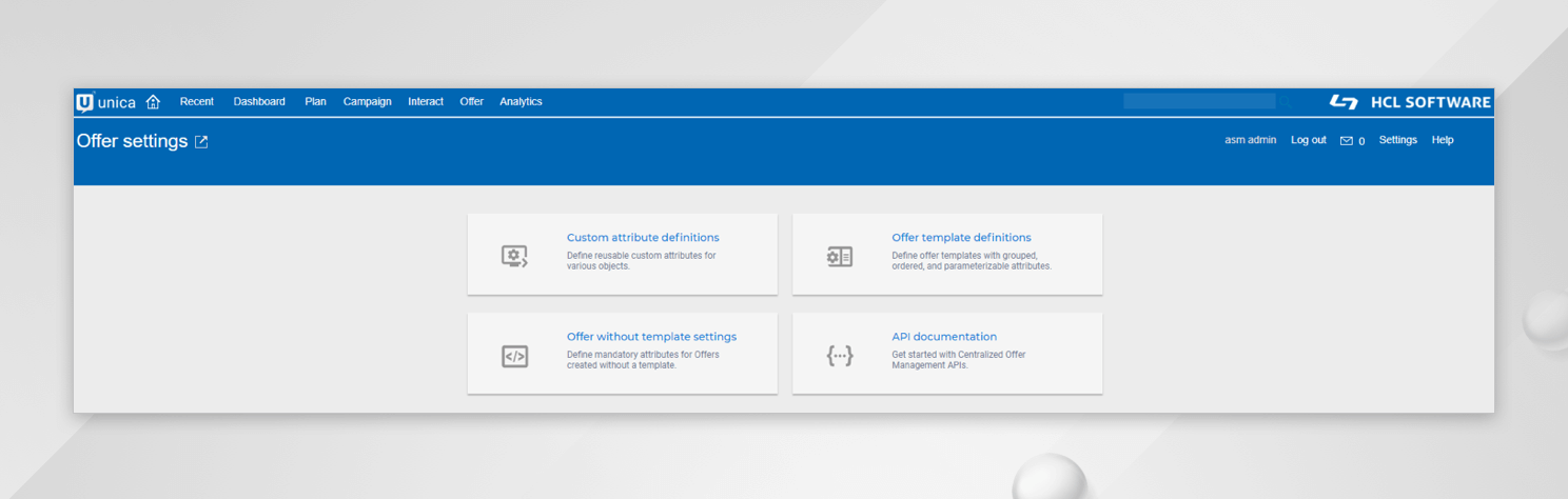

To create an offer attribute, you need to navigate Setting Offer settings and then click on ‘Custom attribute definitions.’ On this page, you have a button ‘Add custom attribute’ to add a new attribute. You can fill the necessary details below to create a new custom attribute for the Offer.

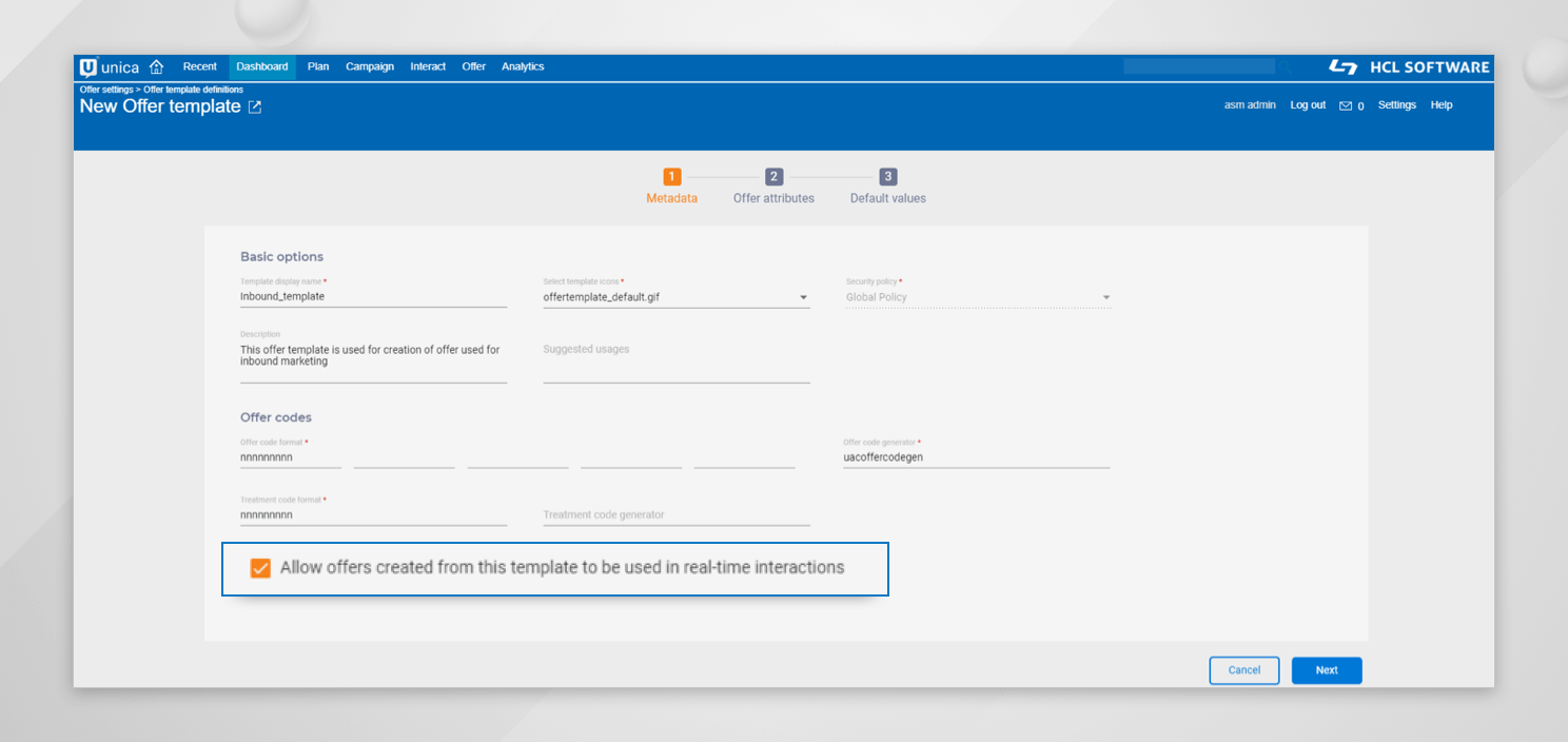

To create an offer template, navigate to Setting Offer settings, and click on ‘Offer template definitions.’ On this page, you have the ‘Add new template’ button to create a new offer template. On the ‘Metadata’ page, provide the necessary details, and then click on ‘Next.’

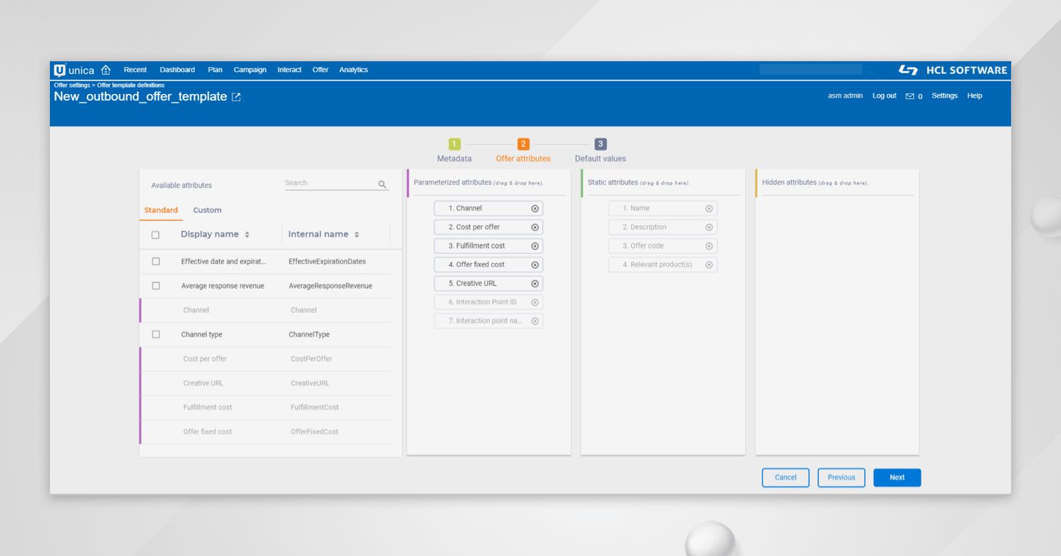

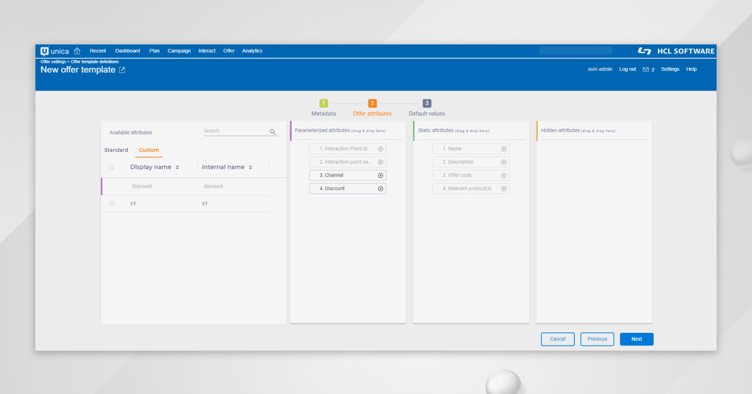

The above-highlighted option ‘Allow offers created from this template to be used in real-time interactions’ should be selected only when you plan to use the offers to Interact for real-time marketing. On the ‘Offer attributes’ section, drag-drop the required attributes in the appropriate section, as shown below.

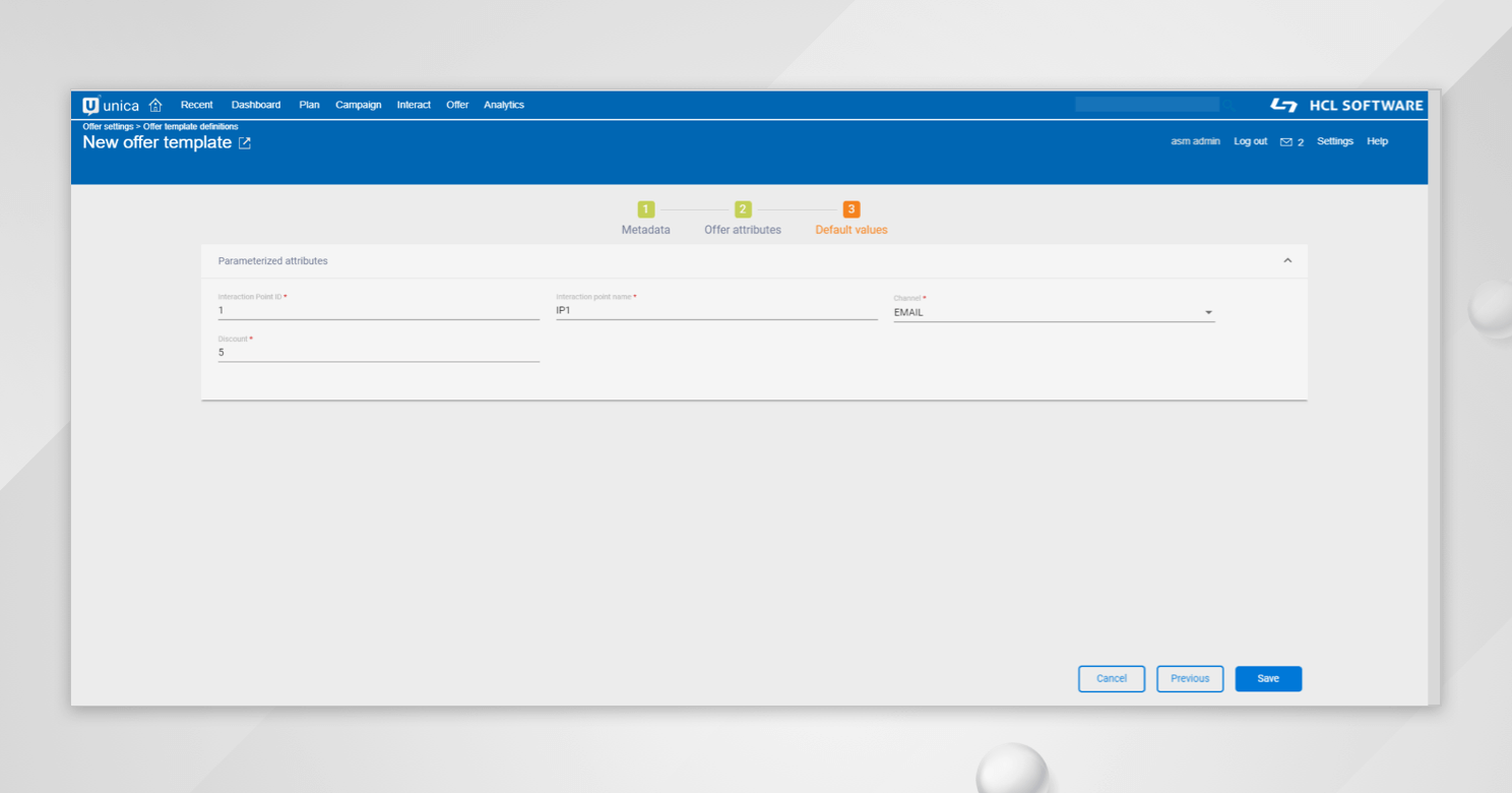

On the ‘Default values’ section, you need to provide the default values for all the attributes selected earlier, as shown below. After that, you can click the ‘Save’ button to complete the creation of the offer template.

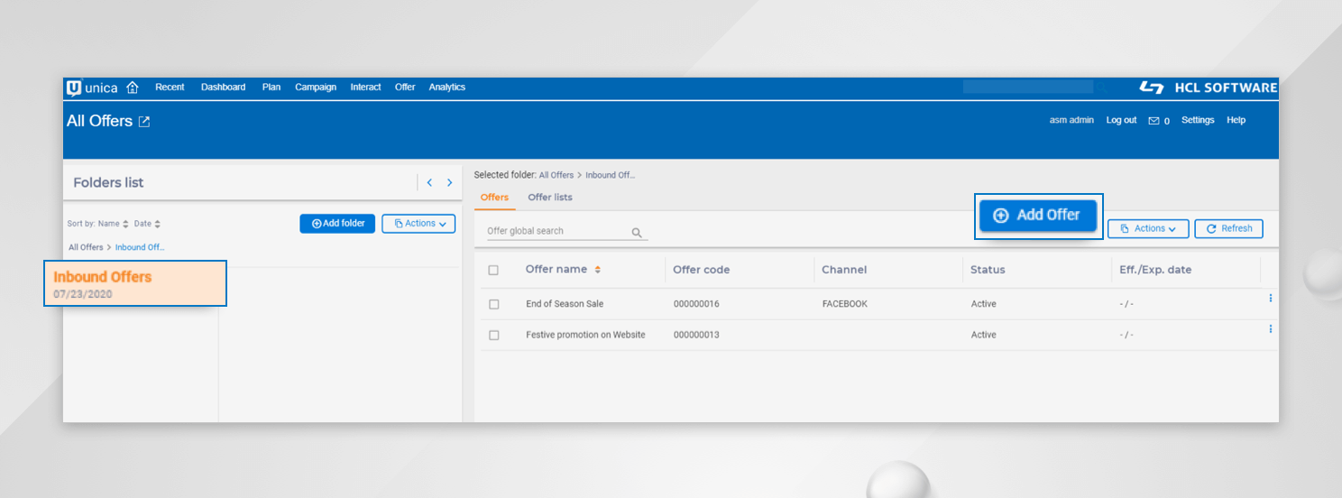

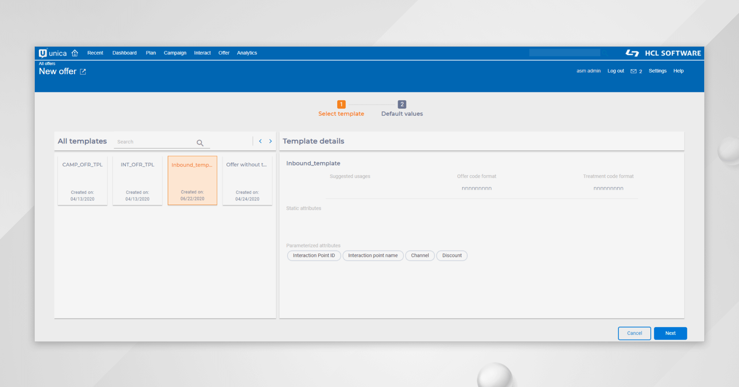

For the creation of an offer, navigate to Offer Offers from the top navigation bar. Then from the left navigation pane, select the appropriate folder, and then click on ‘Add Offer’ from the right navigation pane.
This action will open a screen to choose the required offer template. You need to select the desired offer template and then click on ‘Next.’

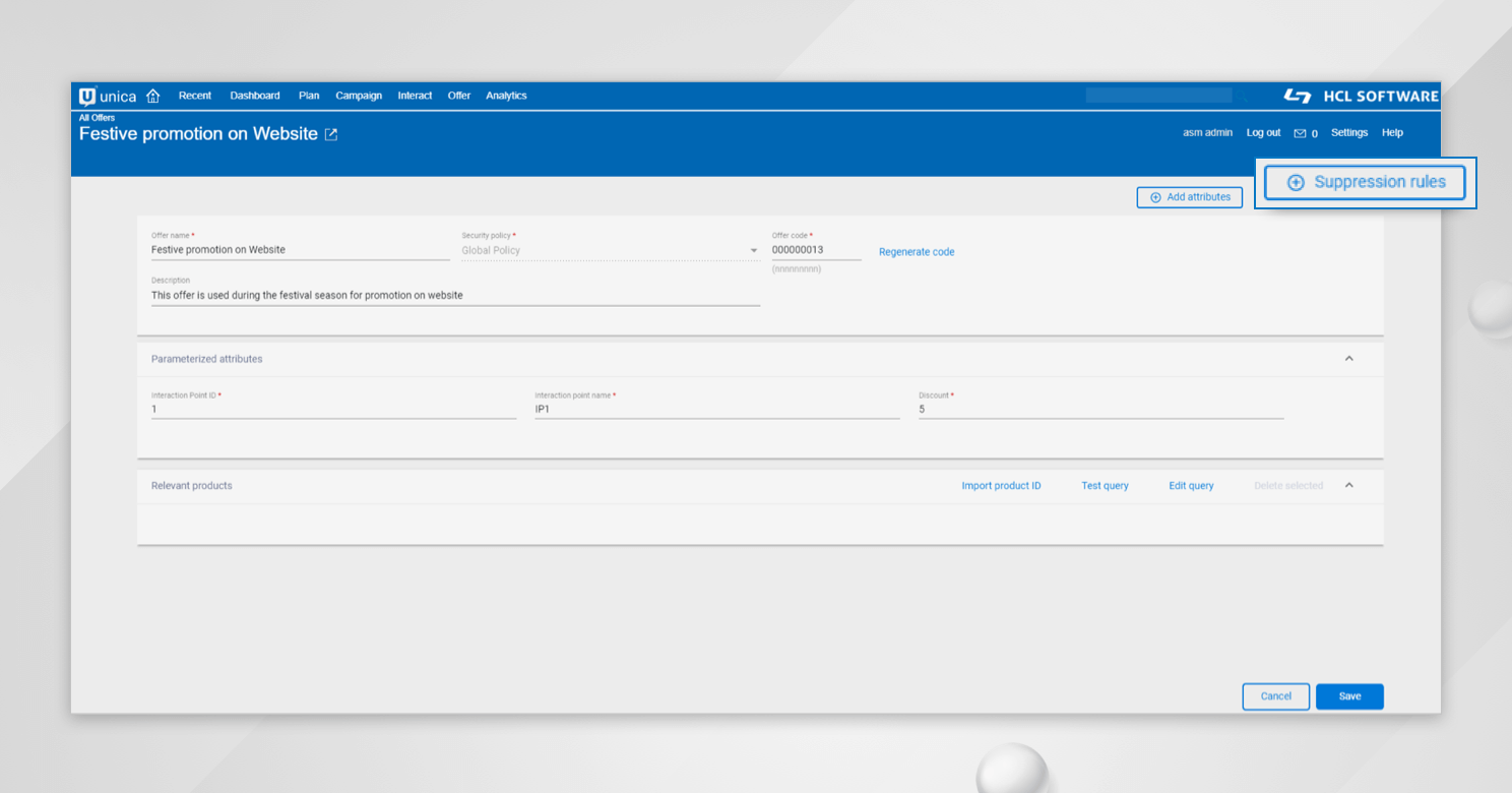

On the next screen, you have an option to provide the details about the offer attributes and also define the ‘Suppression Rules’ for the same Offer and then click on ‘Save.

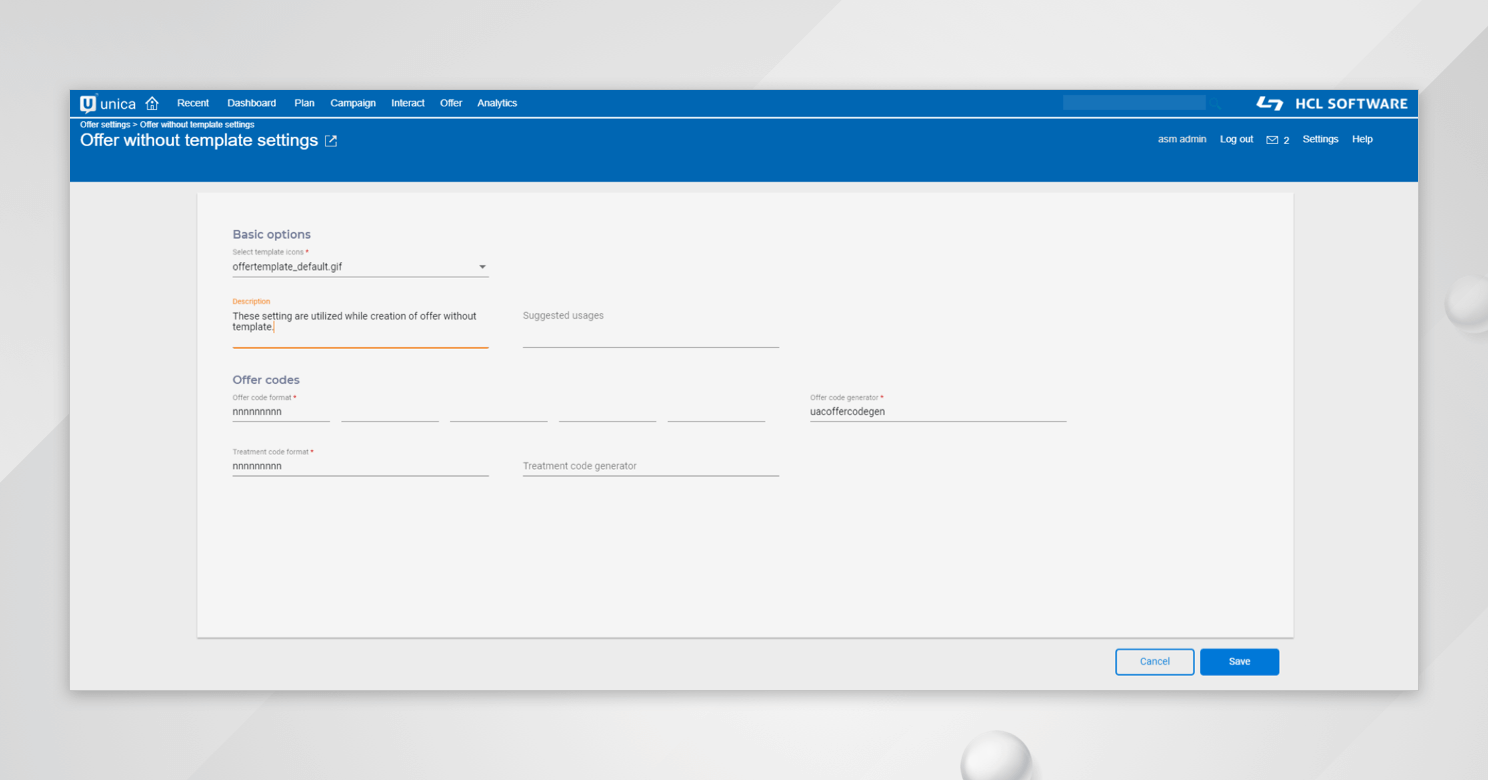

To enable the creation of an offer without a template, you need to navigate to Settings Offer settings and then click on ‘Offer without template setting’ as highlighted in the below screenshot.
This opens a new page that captures few details, as shown below.
Note that this is a one-time activity.

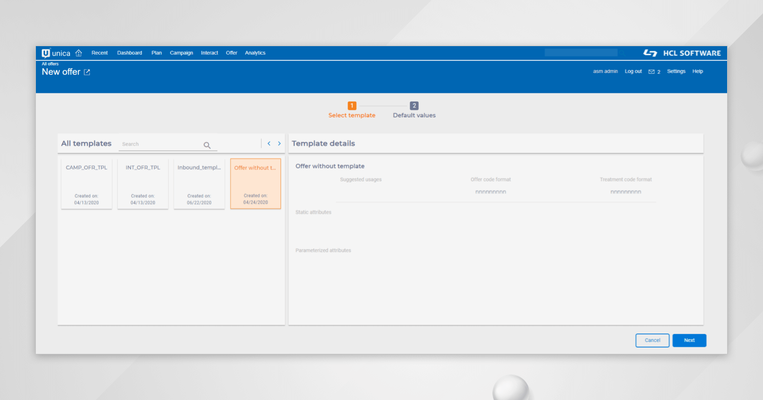

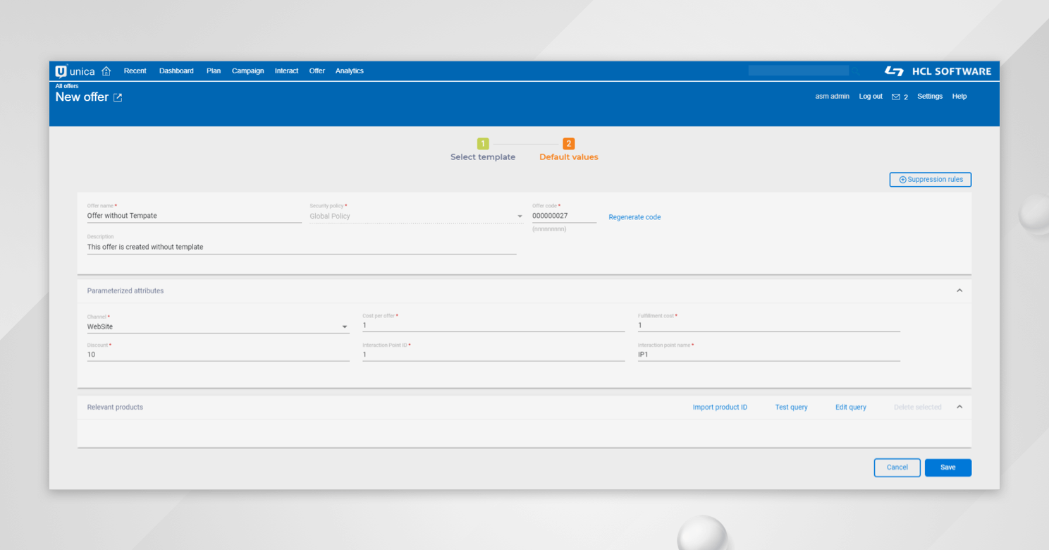

Once these settings are saved, you can create a new offer without any template. For that, click on Offer Offers from to menu option. After selecting the appropriate folder, you can click on the ‘Add Offer’ button. You will be shown the below screen from where you can select the ‘Offer without template’ option.

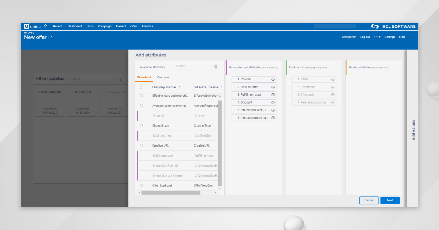

Then click on the ‘Next’ button. This action opens a popup window from where you can select the appropriate offer attributes like below.

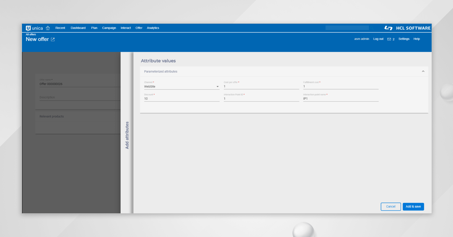

After selecting the required attributes, click on ‘Next.’ This will take you to the next screen where you can provide the values for the offer attributes chosen earlier.
Then click on the ‘Add & Save’ button, which navigates the user where he needs to provide like below.
And then click on ‘Save’ to create an offer.

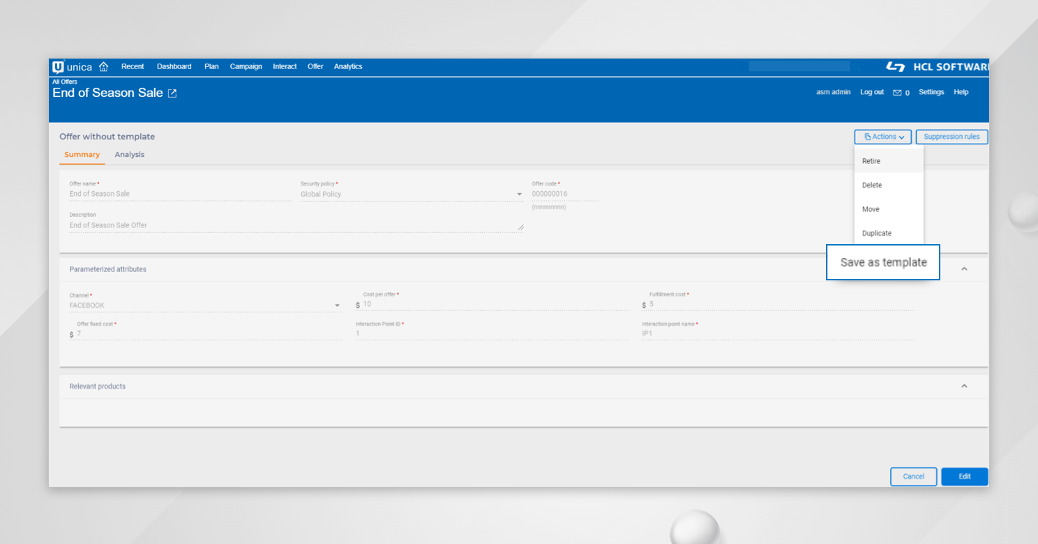

This option is available from the Offer (s), which is created without a template. To achieve this, open an offer, which is created without a template. Then click on ‘Actions’ like below. This will give an option ‘Save as template’ which facilitates the user to create an Offer template.

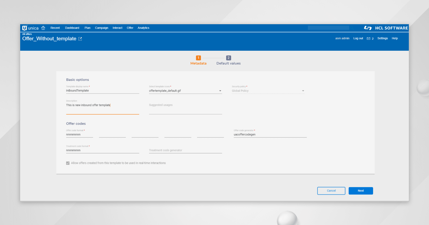

This opens a new screen where the user needs to provide ‘Metadata’ for the offer template like below.

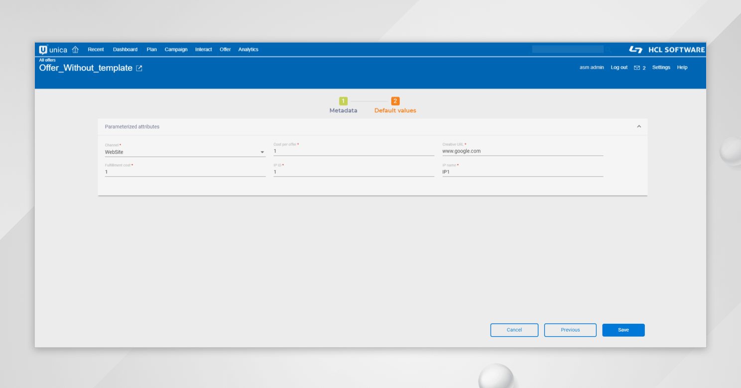

After clicking on ‘Save,’ the user will be navigated to a new screen like below where he can provide the default value for the offer attributes which were selected for that Offer.
Clicking on ‘Save’ will create a new Offer template and will be available for the creation of a new offer going forward.

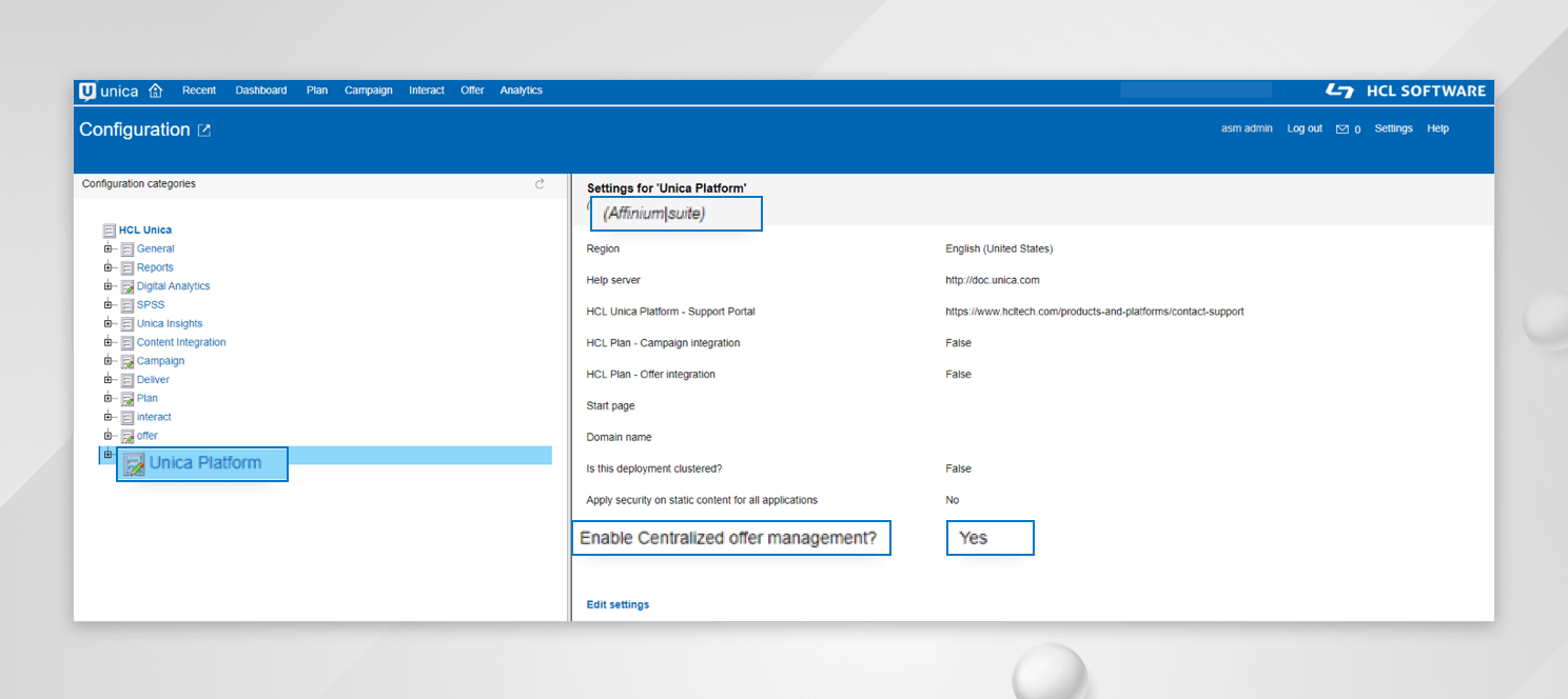

4. The Centralized Offer Management module can be enabled or disabled using the flag property highlighted in the below screenshot.
