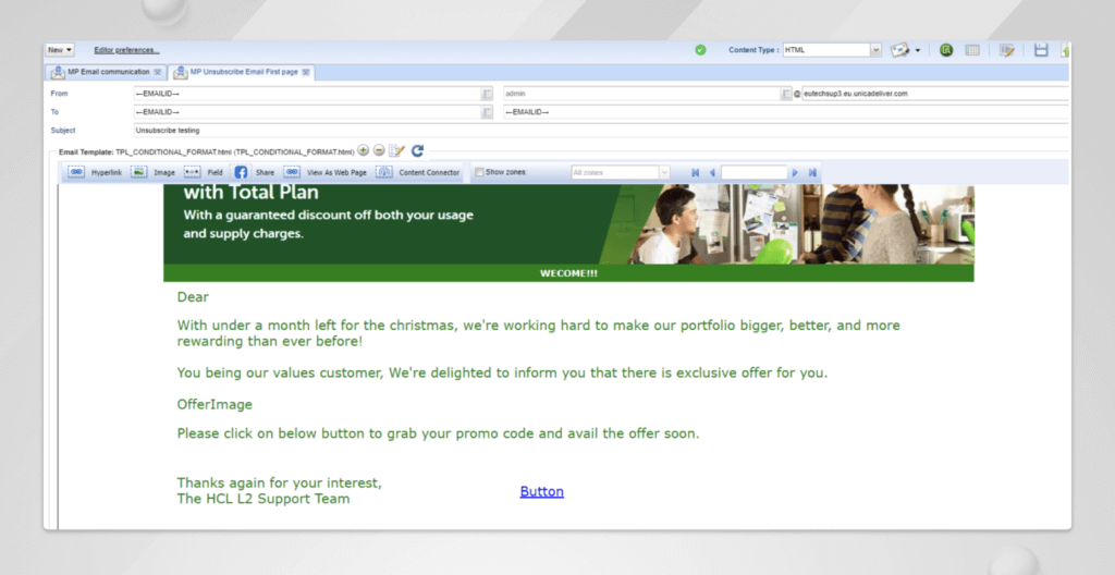

1. Create an email communication and add a Zones/button/link to unsubscribe the email in the email communication as below.

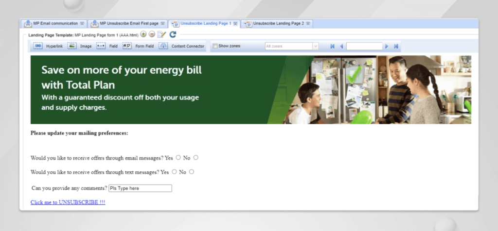

2. Create a Landing Page where user can define the hidden attribute e.g. UNSUB_EMAILID whose value is name email id attribute name. For example (<input type=”hidden” name=”UNSUB_EMAILID” value='<UAEpf n=”EMAILID”/>’/>).
Unsubscribing Email in Unica Deliver

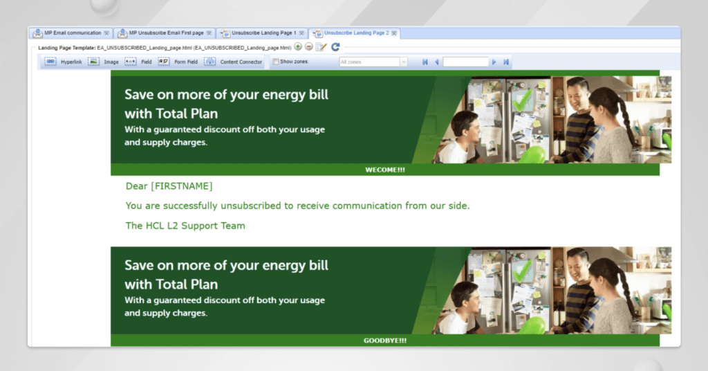

3. Create second Landing Page communication for confirmation of Un-Subscription as shown below.

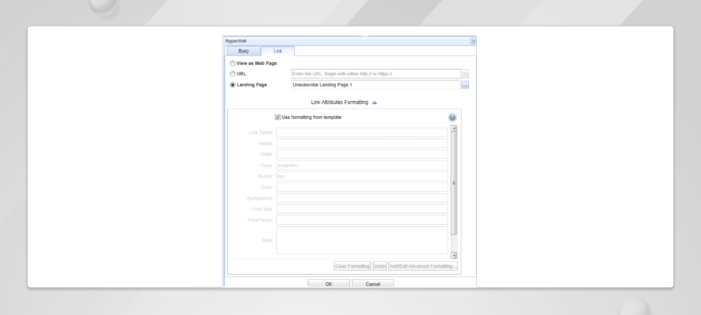

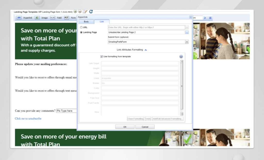

5. From Landing Page1, add a link to Landing Page2 as shown below. While adding a link, make sure you select “Submit form (optional)”.

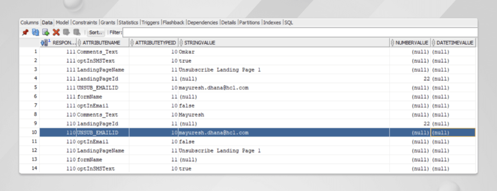

6. Now create a Campaign flowchart to generate OLT and send Email communication. After the user opens the Email communication and clicks on the Unsubscribe button, the response will be captured in the UCC_RESPONSE and UCC_RESPONSEATTR table.

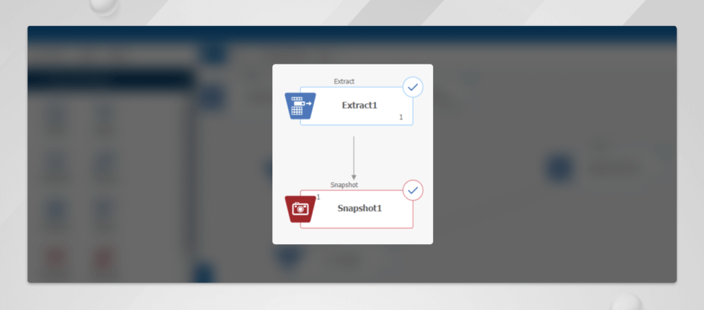

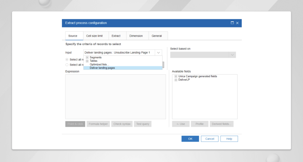

7. Now, create a new Flowchart in the same Campaign and add the Extract Process box. Select the input as Deliver Landing page.

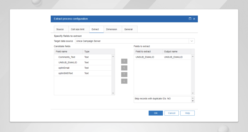

8. In the Extract tab, select the field to extract, i.e., UNSUB_EMAILID
9. Add the Snapshot process (To write to Suppression table) to the Extract Process box and run the flowchart.

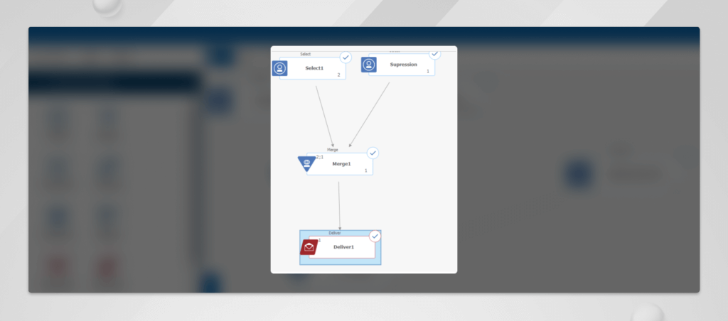

10. In the flowchart where the OLT list is created, select from Suppression Table to exclude the suppression list from the Suppression table.

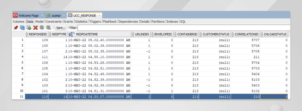

2. Once the user replies to an email communication with one of the above keywords, the responses get processed, and the UCC_RESPONSE table will get populated with the RESPTYPE=10 (Email – Unsubscribe)

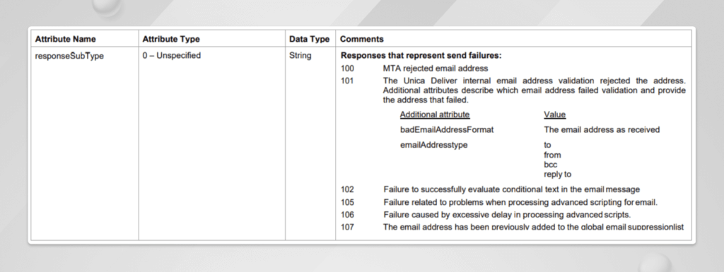

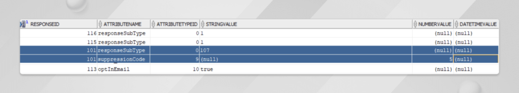

3. Attempt to send email communication to email-id, which is put in Global Suppression list, results in response attribute table (UCC_RESPONSEATTR) getting populated with following records.

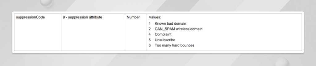

4. AttributeName= suppressionCode, AttributeTypeID=9 and Numeric value 5 indicate that this response is for email-id, which has been put in the Global suppression list.
5. Similarly, you can check for AttributeName= responseSubType, AttributeTypeID=0 and String value 107.
