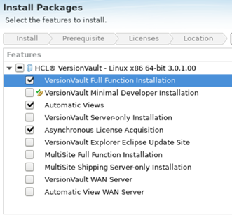

Before installing Jenkins on the Linux host, you must install HCL DevOps Code ClearCase first. You must install the HCL DevOps Code ClearCase Remote Client or HCL DevOps Code ClearCase also ensure that the system path includes /opt/hcl/ccm/HCL DevOps Code ClearCase/bin. In the below example snippet selected "HCL DevOps Code ClearCase Full Function Installation'' which includes a complete feature and if you want to use automatic view for Jenkins builds then you must select "Automatic Views” option during the installation.
Note: For VV 3.0.1 installation you still need to have Java 8 on the same host.

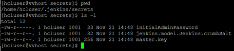

- During the installation of Jenkins, logs and the initial password for Jenkins are created, as shown in the following example:
 By default initalAdminPassword can be found in the user's home directory. Example:
 Tip: Note the password because you need it to unlock Jenkins.

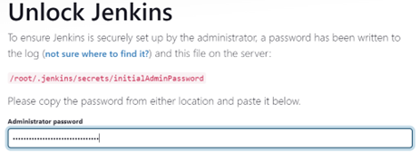

- On the Unlock Jenkins dialog box, in the Administrator password field, enter the password that you got from Step 3 of Jenkins Installation section, or you can get the password from initialAdminPassword file and then click Continue.

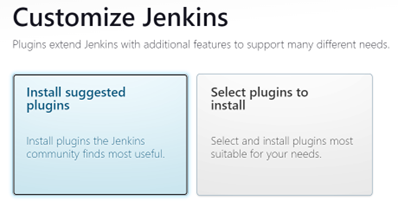

- On the Customize Jenkins dialog box, to have Jenkins automatically install the most frequently used plug-ins, click Install suggested plugins.

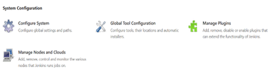

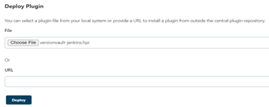

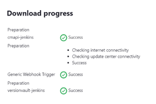

 a) On the left-hand side of Jenkins home page, you will find the "Manage Jenkins" option please select it.   b) If you scroll down under System Configuration you will find "Manage Plugins".   c) Select "Advanced" option under Plugin Manager.   d) Scroll down and go to option "Deploy Plugin". Then select “Choose File” option to select two plugin files i.e., HCL DevOps Code ClearCase-jenkins.hpi and cmapi-jenkins.hpi then click on “Deploy”.   e) Once the two plugin files are deployed you will see the below result.   6. SSL/TLS configuration for Jenkins Server:- If you want to use SSL/TLS for your Jenkins server, consult the Jenkins documentation at https://www.jenkins.io/doc/book/installing/initial-settings/ to use other command line flags instead of the preceding mentioned command line flag.
