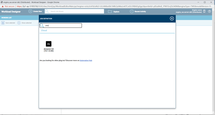

Create a new job and select “Amazon S3” in the Cloud section.

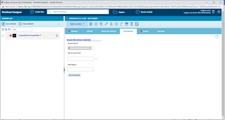

Connection
First, establish a connection to the AWS server by entering the required details.
Then, you can test the connection to AWS server by clicking on Test Connection.
Figure 2: Connection Page

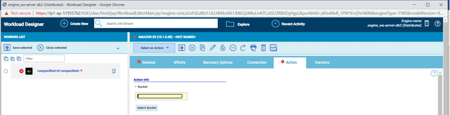

Action
After having successfully tested the connection, you can go to the Action tab and specify the details about the kind of operation you need to perform (upload, download, delete) and the bucket where you need to perform.

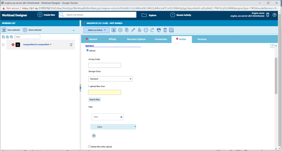

a. Upload:
Use this option to upload the list of files and folder into specified Amazon S3 Bucket, and you can store anywhere in the bucket using the prefix.
You can also use search files option to browse all the files and folders in the given path. This path is taken as parent path and all the files will be taking this as the reference path.
You have an option to delete the files in your system after the upload is complete.
Figure 4: Action Page > Upload section

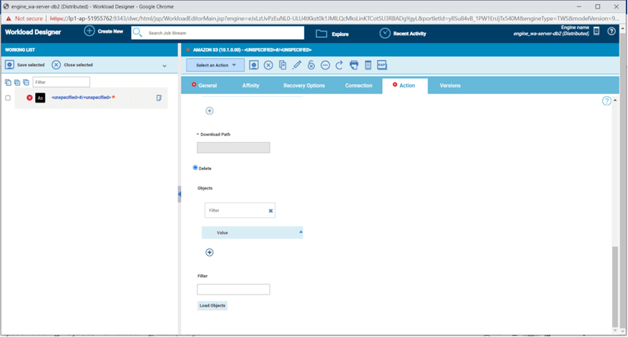

c. Delete:
Use this operation to delete objects on the specified bucket on Amazon S3.
You can use load objects to check the objects that are present in the bucket you have chosen.
Figure 6: Action Page > Delete section

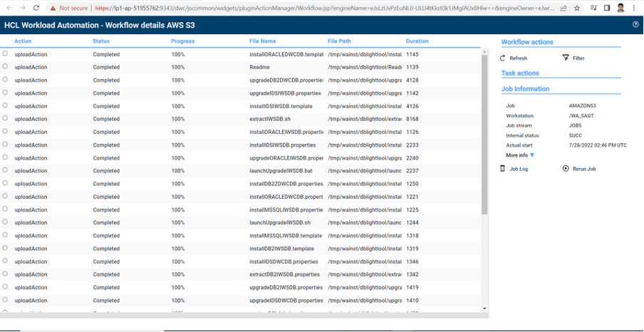

Monitoring your job:
While Amazon S3 executes the process, the plug-in offers the possibility to monitor real-time execution. Such monitor page, called Workflow details, is accessible from the monitor jobs view, and contains all the details about the job. Refresh the page to see the updates.
Figure 7: Workflow Details Page
Thus, thanks to the Amazon S3 plug-in, you can automate your operations on Amazon S3 and monitor them, all from one place.
