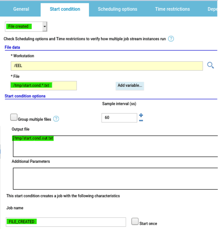

- In the Start condition tab, fill in the values in the fields as shown below:
- Condition: File created An existing file with a matching name will not satisfy the condition, a new file with a matching name must be created.
- Workstation: EEL
- File: /tmp/start.cond.*.txt
- Output file: /tmp/start.cond.out.txt
- Job name: FILE_CREATED A file monitor job with this name is auto generated. This job iteratively keeps monitoring the file and when satisfied, submits a new instance of the Job Stream.

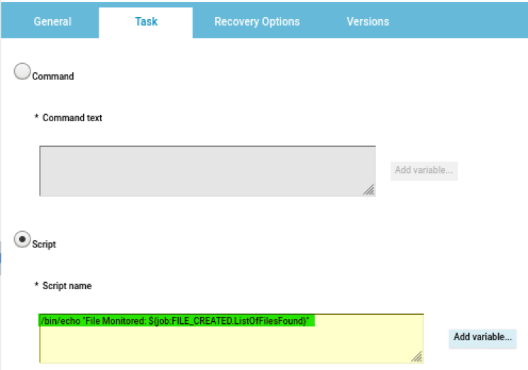

8. In the Task tab, enter the following
Script name: /bin/echo “File Monitored: ${job:FILE_CREATED.ListOfFilesFound}”

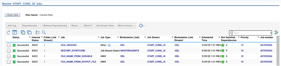

- In the resulting view, Right Click on the Job Stream, START_COND_JS, and choose Jobs
- Notice that there are 4 jobs in the Job Stream
FILE_CREATED Auto generated job to keep monitoring the file
RESTART_STARTCOND Auto generated job to submit the Job Stream
FILE_NAME_FROM_VARIABLE Job to retrieve the matching file from a variable
FILE_NAME_FROM_OUTPUT_FILE Job to retrieve the matching file from an output file

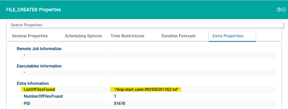

7. Left click on the Job, FILE_CREATED, to view its properties. Click on Extra Properties tab to view the internal variable that stores the name of the matching file.

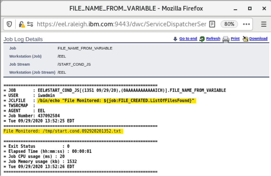

8. Right click on the Job, FILE_NAME_FROM_VARIABLE, and choose Job Log. Notice that the name of the matching file is retrieved from the internal variable, ListOfFilesFound, set by the job,
FILE_CREATED, ${job:FILE_CREATED.ListOfFilesFound}.
File Monitored: /tmp/start.cond.092920201352.txt

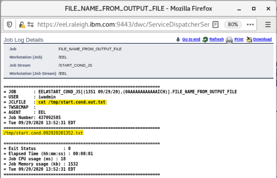

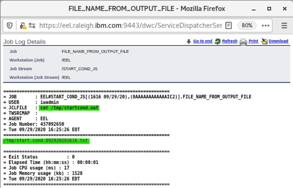

9. Right click on the Job, FILE_NAME_FROM_OUTPUT_FILE, and choose Job Log. Notice that the name of the matching file is retrieved from the file name specified in the Output file field,
cat /tmp/start.cond.out.txt

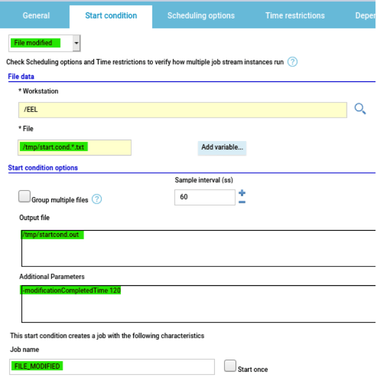

How to use the Start Condition feature with File Modified
Follow the steps below to create a Start Condition for a Job Stream
- Login to the Dynamic Workload Console
- Navigate to Design à Manage Workload Definitions
- Select Create New à Job Stream
- In the General tab, fill in the Job Stream name and Workstation
- Condition: File modified An existing file with a matching name will not satisfy the condition, the file with a matching name must be modified.
- Workstation: EEL
- Output file: /tmp/startcond.out Must have a different pattern than the file being monitored.
- Additional Parameters: -modificationCompletedTime 120 When a file is modified, the event is not sent immediately, but only after the interval of time specified by -modificationCompletedTime <seconds> has elapsed and during which no additional changes were made to the file. For other parameters, refer to Chapter 16, Using utility commands, in the IBM Workload Scheduler version 9.5 User’s Guide and Reference.
- Job name: FILE_MODIFIED A file monitor job with this name is auto generated. This job iteratively keeps monitoring the file and when satisfied, submits a new instance of the Job Stream

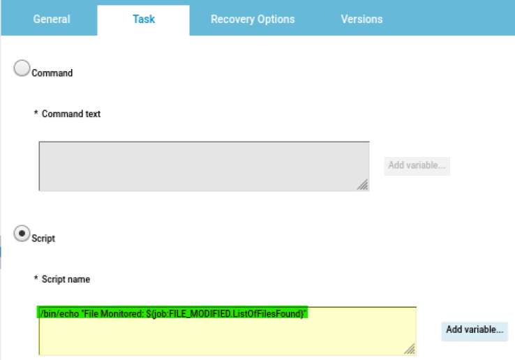

Script name: /bin/echo “File Monitored: ${job:FILE_MODIFIED.ListOfFilesFound}”
9. Click on Save

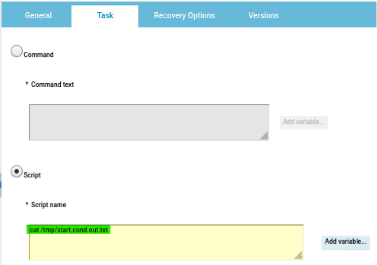

12. In the Task tab, enter the following
Script name: cat /tmp/startcond.out
13. Click on Save

16. The following is the Job Stream definition is composer format.
| SCHEDULE EEL#START_COND_JS
STARTCOND FILEMODIFIED EEL#”/tmp/start.cond.*.txt” INTERVAL 60 ( ALIAS FILE_MODIFIED RERUN PARAMS “-modificationCompletedTime 120” OUTFILE “/tmp/startcond.out” ) : EEL#FILE_NAME_FROM_VARIABLE SCRIPTNAME “/bin/echo \”File Monitored: ${job:FILE_MODIFIED.ListOfFilesFound}\”” STREAMLOGON iwadmin DESCRIPTION “Retrieve file name in Start Cond from an internal variable, ListOfFilesFound” TASKTYPE UNIX RECOVERY STOP
EEL#FILE_NAME_FROM_OUTPUT_FILE SCRIPTNAME “cat /tmp/startcond.out” STREAMLOGON iwadmin DESCRIPTION “Retrieve file name in Start Cond from the Output file field” TASKTYPE UNIX RECOVERY STOP FOLLOWS FILE_NAME_FROM_VARIABLE
END |

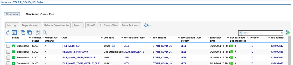

FILE_MODIFIED Auto generated job to keep monitoring the file

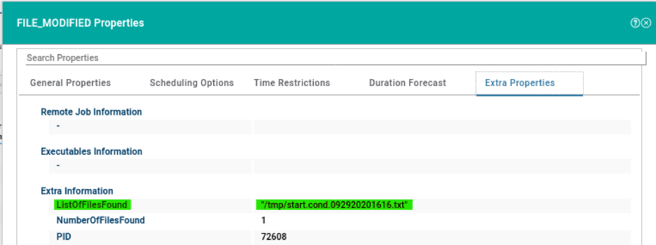

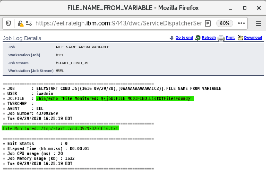

FILE_CREATED, ${job:FILE_MODIFIED.ListOfFilesFound}.
