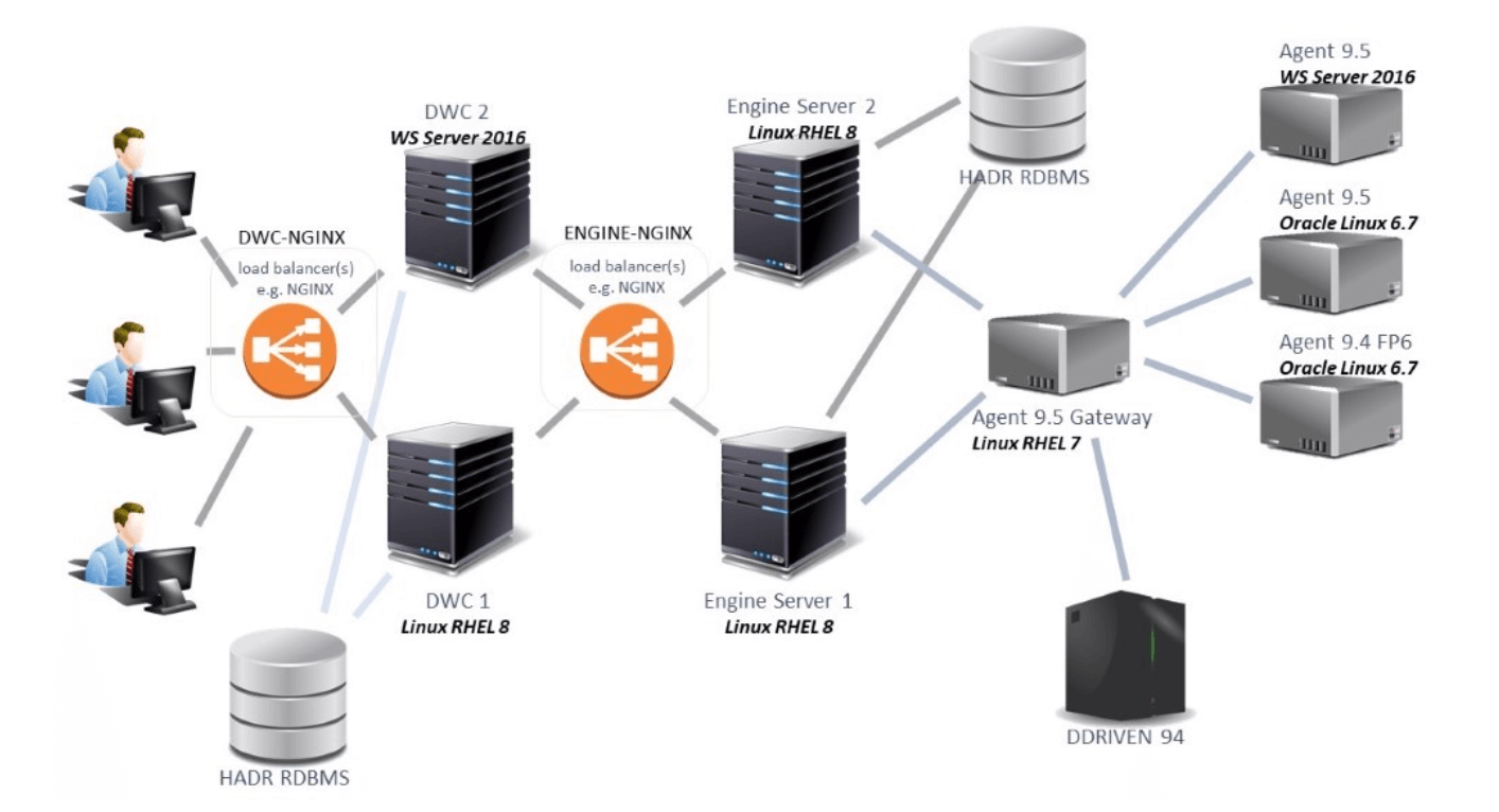

automatic failover svt environment
Figure 1: Automatic Failover SVT environment
In Figure 1, the load balancers are depicted as two distinct ones, the most general case possible, but for the SVT environment, we have used a single component for balancing the request to the DWC machines and to the server machines.
