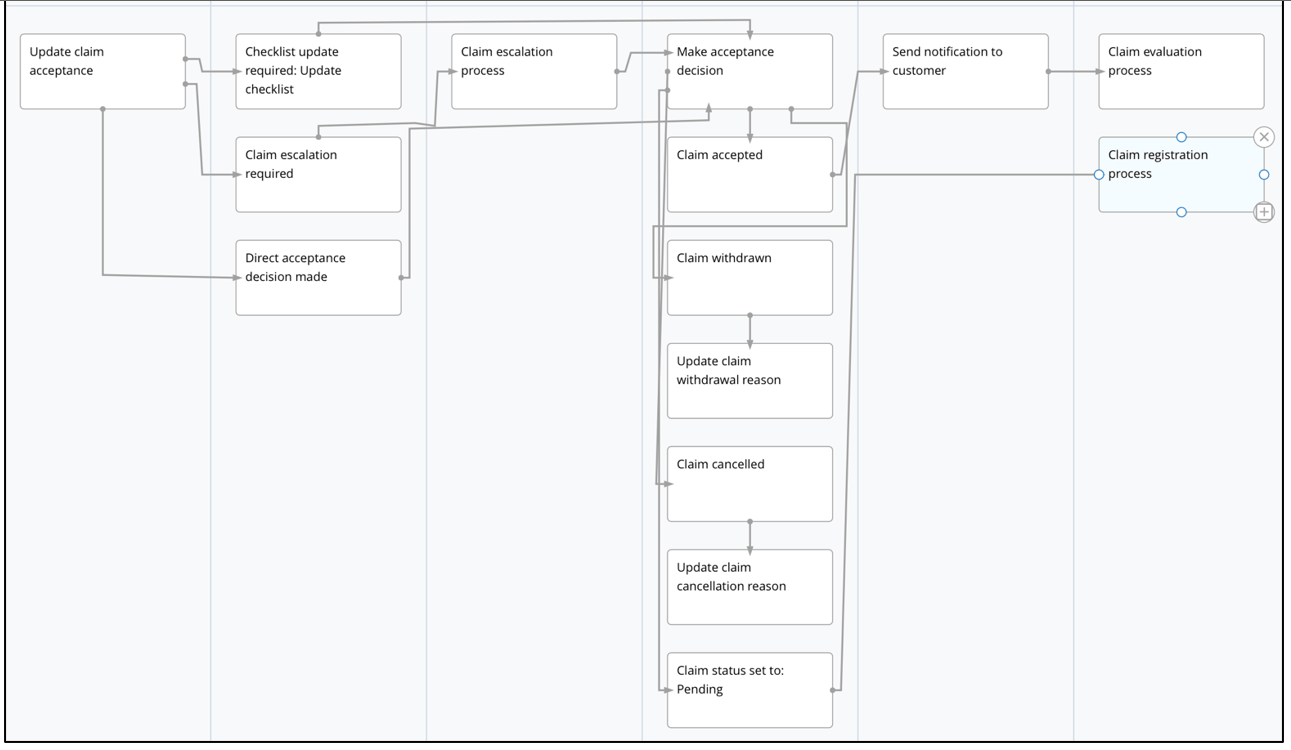

Here, we examine the below process and try to mimic it using HCL Workload Automation.
A screenshot of a diagram Description automatically generated with low confidence
An insurance claim during the acceptance process undergoes completeness checks to make sure all documentation has been submitted as part of the claim. The results of the checks could lead to an email notification being sent to the contact or it could allow the process to go onto the next step.
The next step is if the claim needs to be escalated. The escalation requirement could result in either the escalation sent to a portal for further review and approval.
In case escalation is not needed for the claim case, it would undergo acceptance check and result in the claim set to pending in case some further clarifications are needed or result in claim being accepted and registered into the system.

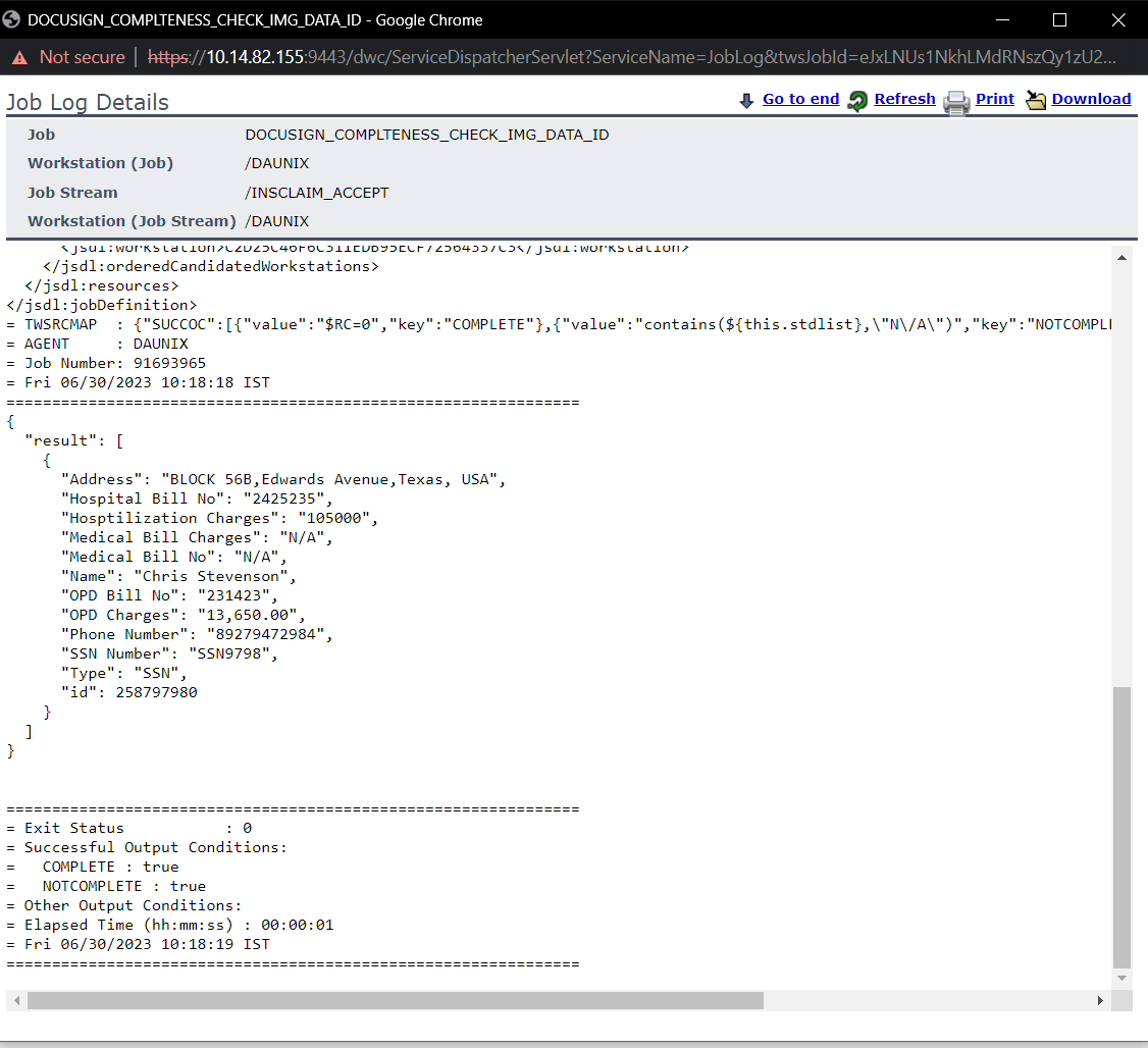

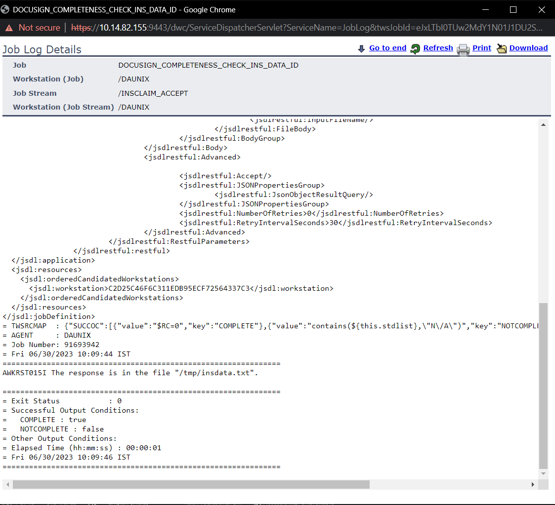

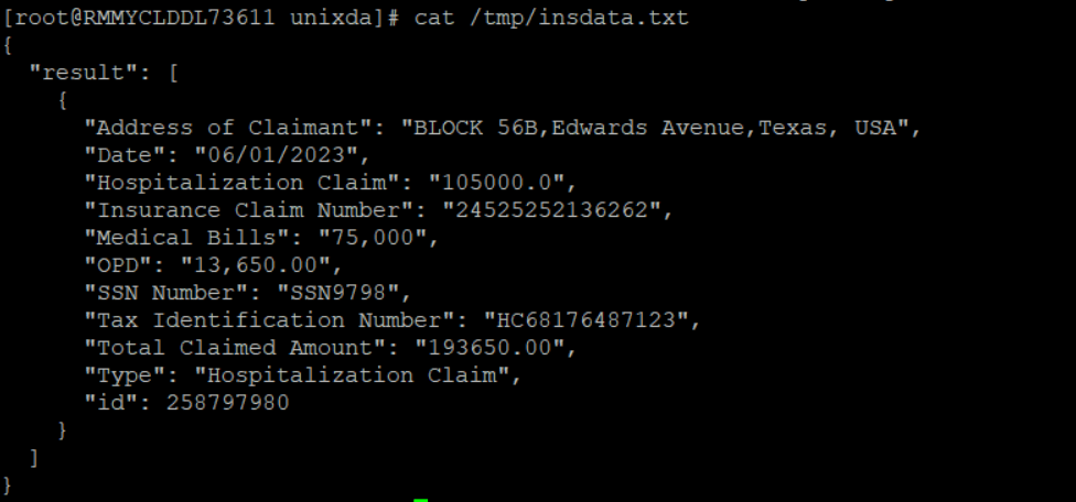

The completeness check of the insurance form data is performed via HWA job realized as a RESTFUL GET job which would leverage Docusumo APIs to perform a RESTFUL GET operation to get the data from a Mongo DB (where all data resides):
The joblog of this job would be as follows:
A screenshot of a computer Description automatically generated

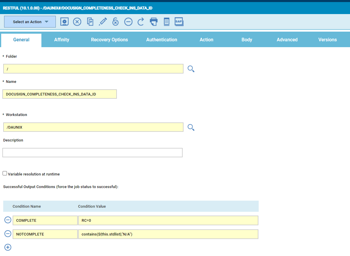

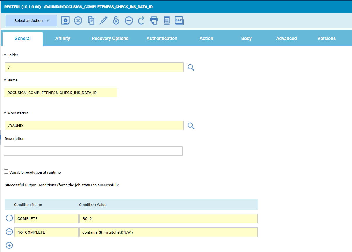

This job would also have conditional dependencies to determine if the data is complete:
So, this looks for the keyword β€œN/A” in the joblog and decides whether the data is complete or if there are missing fields in the scan done earlier from Docusumo:

The completeness check of insurance attachment data is done via a by making a RESTFUL GET call via an HWA Job into the same Mongo DB serviced via an Internal API running in the background:
The completeness check of documentation data is again validated with conditional dependencies defined at the job level where the string β€œN/A” in the joblog indicates this data was not available in the scan or is missing, this would result in the condition β€œNOTCOMPLETE” getting satisfied:

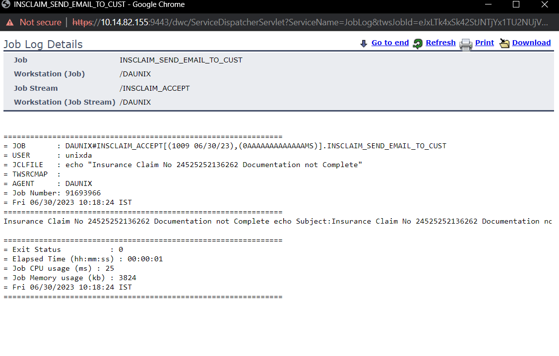

If the β€œNOTCOMPLETE” condition is satisfied, this results in a mailing job to send notification to the customer via email to intimate him about the missing data.
Email notification job for completeness check of image data (attachment data):
The mail notification job sends a notification out that the documentation is not complete:

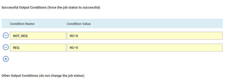

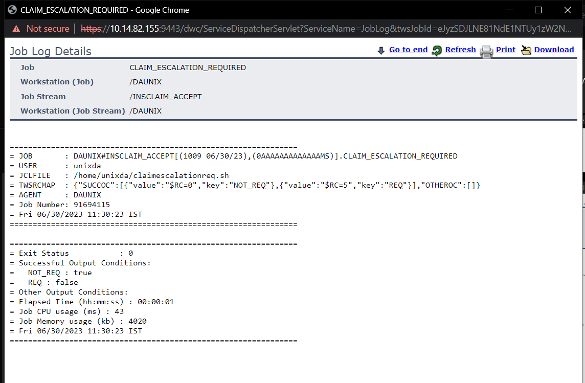

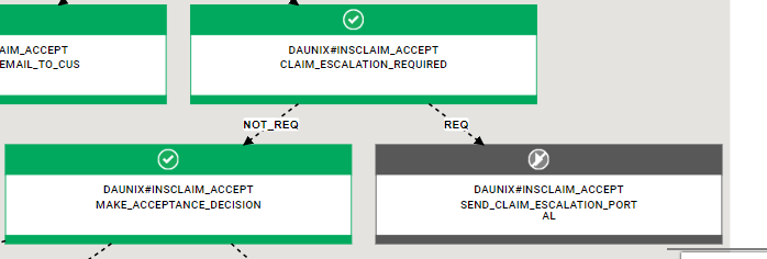

This is realized as Unix Job to check if a claim escalation is needed in this case, so the script called evaluates if the value returned is beyond a particular value:
There would be conditional dependencies defined where every Return Code is mapped to β€œREQ”, β€œNOT_REQ”. So, depending on the Return Code 5 or 0, the corresponding conditions are passed that is Required and Not Required.
In case escalation is required, SEND_CLAIM_ESCALATION_PORTAL job is called to do a RESTFUL POST job into the Portal such that the Claim is escalated for further approvals to higher Management in case the amount is beyond a particular value.

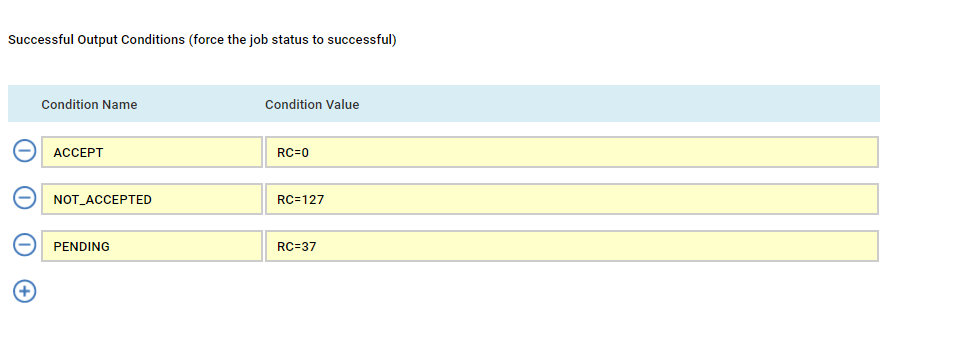

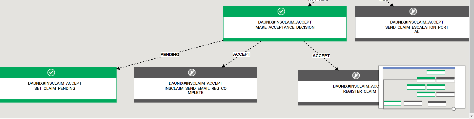

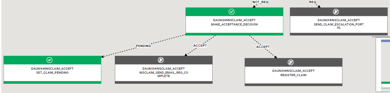

There would be conditional dependencies defined where every Return Code is mapped to either β€œACCEPT”, β€œNOT_ACCEPTED” and β€œPENDING”. So, depending on the Return Code 127, 37 or 0, the corresponding conditions are passed.
A picture containing text, line, diagram, font Description automatically generated

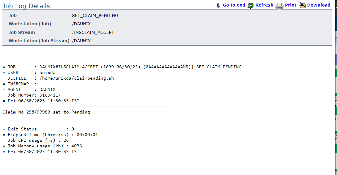

SET CLAIM PENDING Job:
This job sets the claim to pending in the Mongo DB, so that the claim could further evaluated manually for further checks from the insurance company:
A screenshot of a computer Description automatically generated with medium confidence
In case β€œACCEPT” condition is passed, the claim is accepted through β€œRESGITER CLAIM” job & a mail notification is sent out via Mailing job to intimate the registration of the claim is completed successfully.

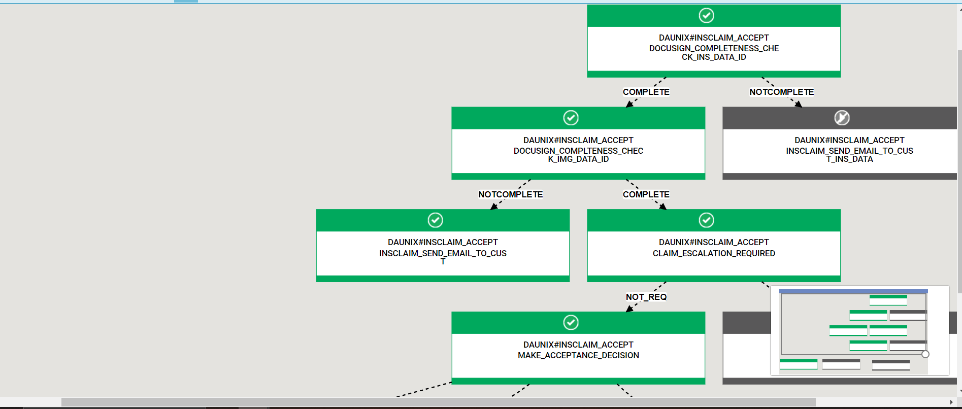

Whole Flow at HWA Side:
A picture containing text, font, line, diagram Description automatically generated
