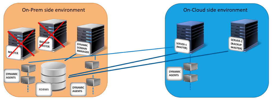

Step3: Permanently switch the master domain manager role from the on-premises master domain manager to the server installed in the cloud environment
As a third step, you must switch the on-premises master domain manager as a backup for the server-1 server installed in the AWS EKS cluster. The server-1 server deployed in the AWS EKS cluster becomes the master domain manager that orchestrates all the daily scheduling and the topology network. In the AWS EKS cluster, add a second server called, server-2, that has the role of backup master for the server-1 master.
After a few days, if the daily scheduling continues to work without any problems, you can think to shut down and/or decommission the master and backup master installed on the on-premises side.
server becomes the master domain manager
Fig 3. The server-1 server becomes the master domain manager for the entire WA network

Step 3: Permanently switch the master domain manager role from the on-premises master domain manager to the server installed in the cloud environment
Now you can complete the procedure of switching your master domain manager role from the on-premises environment to the cloud environment by following these last few steps. By the end of this process, the scheduling of your environment is completely managed by the server installed on the cloud and you can benefit from all the advantages that this entails.
  1. Switch the event processor from the on-premises master to the server (server-1) in the AWS EKS cluster by using the following conman command from the on-premises master or cloud server:
switcheventprocessor server1
where server1 is the name of the on-cloud master domain manager workstation.
2. Switch the domain manager capabilities from the on-premises master to the server in the AWS EKS cluster, by running the following conman command from the on-premises master or cloud server:
switchmgr domain;server1
3. Assign full control for all objects and folders to the wauser, that is the WA user for the server installed in the cloud. Use the composer command-line command to modify the access control list in the following way:
composer mod acl @
ACCESSCONTROLLIST FOR ALLOBJECTS
root FULLCONTROL  twsuser FULLCONTROL
wauser FULLCONTROL
END
ACCESSCONTROLLIST FOLDER /
root FULLCONTROL
twsuser FULLCONTROL
wauser FULLCONTROL
END
To make the switch permanent:
a. Edit the definition of the on-premises master domain manager using composer and modify the TYPE attribute from MANAGER to
b. Edit the definition of the server installed on the cloud using composer and modify the TYPE attribute from FTA to MANAGER.
c. Run the following command for the changes to take effect.
JnextPlan -for 0000
d. Edit the FINAL and FINALPOSTREPORT job streams following these steps:
composer mod js your_xa#final@ full
e.  Edit the STREAMLOGON section, changing the previous user to wauser
f. Delete the FINAL and FINALPOSTREPORTS job streams from the plan for the on-premises master domain manager, as follows:
conman “canc your_xa#FINALPOSTREPORTS”
conman “canc your_xa#FINAL”
g. Submit first the FINAL, and then the FINALPOSTREPORTS job streams for the on-cloud server into the current plan, as follows:
conman sbs your_xa#FINAL
conman sbs your_xa#FINALPOSTREPORTS
h. Set the value of the limit job stream keyword for the FINAL and FINALPOSTREPORTS job streams for the on-cloud server, both in the database and in the plan, as follows:
conman “limit your_xa#FINAL ;10”
conman “limit your_xa#FINALPOSTREPORTS ;10”
You can optionally decide to deploy a new server with the backup master role in the cloud by performing a scale up of the server component listed in the values.yaml file. To perform this operation, set the waserver.replicaCount parameter to 2.
To have more than one server as a backup in the cloud, you can set the waserver.replicaCount parameter to a value greater than 2.
After testing this new WA deployment with the master workstation and its backups in the cloud environment, you can now decommission your on-premises master and backup master domain managers. At the end of this scaling up and decommission phase, you have the situation shown in Fig 3.
To allow the correct functioning of the on-premises dynamic agents with your master domain manager in the cloud environment, you need to copy the certificates located in the /home/wauser/wadata/ITA/cpa/ita/cert/ directory on the dynamic agents and duplicate them in the /datadir/ITA/cpa/ita/cert directory of the server installed in AWS EKS cluster. You must duplicate the following certificates:
  • TWSClientKeyStore.crl
  • TWSClientKeyStoreJKS.jks
  • TWSClientKeyStoreJKS.sth
  • TWSClientKeyStore.kdb
  • TWSClientKeyStore.rdb
  • TWSClientKeyStore.sth
You have now successfully switched your master domain manager to the cloud and set up your on-premises dynamic agents to work in SSL mode with the server instance deployed in the AWS EKS cluster.
