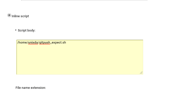

GIT_PUSH Job:
The GIT Push Job would push the Application Code and Scheduling Objects Definitions to the target PROD Repo on GIT and would pass conditional dependencies PUSHSUCCEDDED(RC=0) incase the promotion of Application Code+Scheduling Objects was Successful else would return PUSHFAILED (RC>0 non-Zero Return Code) to indicate that the push was not Successful.

Likewise we have similar GITPush jobs called GIT_PUSH_PREPROD_REPO for the other Flow to promote from QA to Preprod.

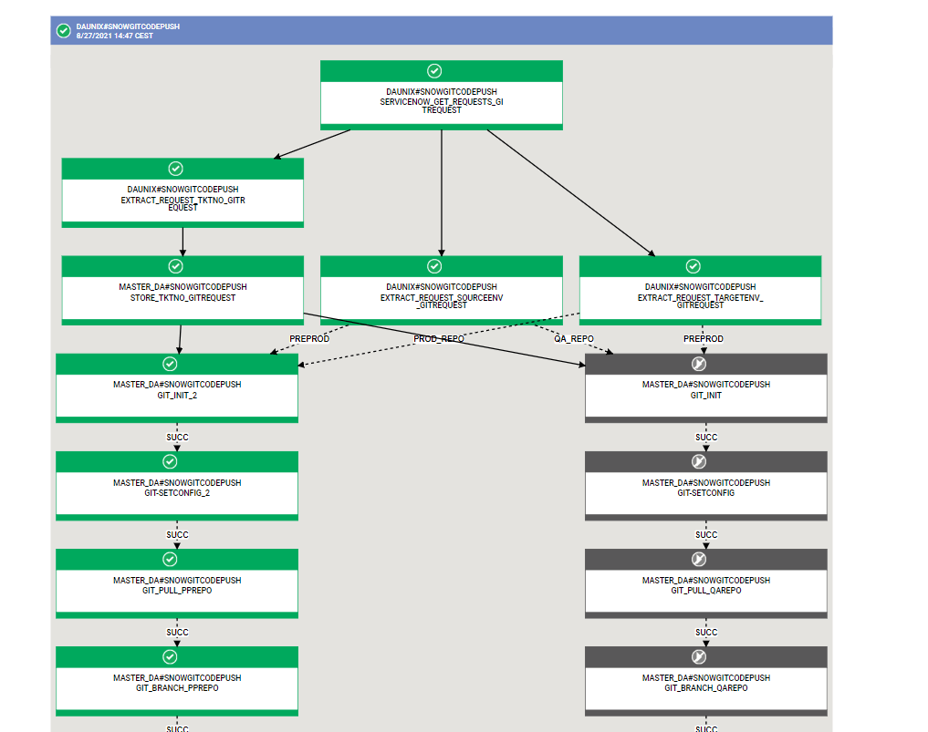

Here’s the Jobstream once it is fully developed to include two branches from QA to PRE-PROD and from PRE-PROD to PROD depending on the input in the Service Now Request:

We have conditional dependencies defined depending on the inputs in the SNOW Request which could be Source ENV : PRE-PROD to Target ENV : PROD or Source ENV : QA to Target ENV : PROD , likewise two Flows Branch out from these two jobs one to promote Application Code+Scheduling Objects from Pre-PROD to PROD or from QA to PreProd:
HWA-GIT-SNOW IntegrationFig18
Each of the two Flows would run : GIT Init , GIT Set Config , GIT Pull Repo , GIT New Branch , GIT Add , GIT Remote Add , GIT Commit and GIT Push Steps.
HWA-GIT-SNOW IntegrationFig19
Conditional Dependencies are defined from the GIT Push Steps called PUSHSUCCEDDED and PUSHFAILED.
HWA-GIT-SNOW IntegrationFig20
A Join Dependency defines an OR Condition that gets satisfied when one of the GIT Push jobs in one of the Flows passes PUSHSUCCEDDED Condition.
The Whole flow when executed against this request would run as follows:
Fig21
HWA-GIT-SNOW IntegrationFig22
The Flow which gets executed depending on the conditional dependencies from Source ENV and Target ENV Jobs would run while the other Flow would get supressed .
