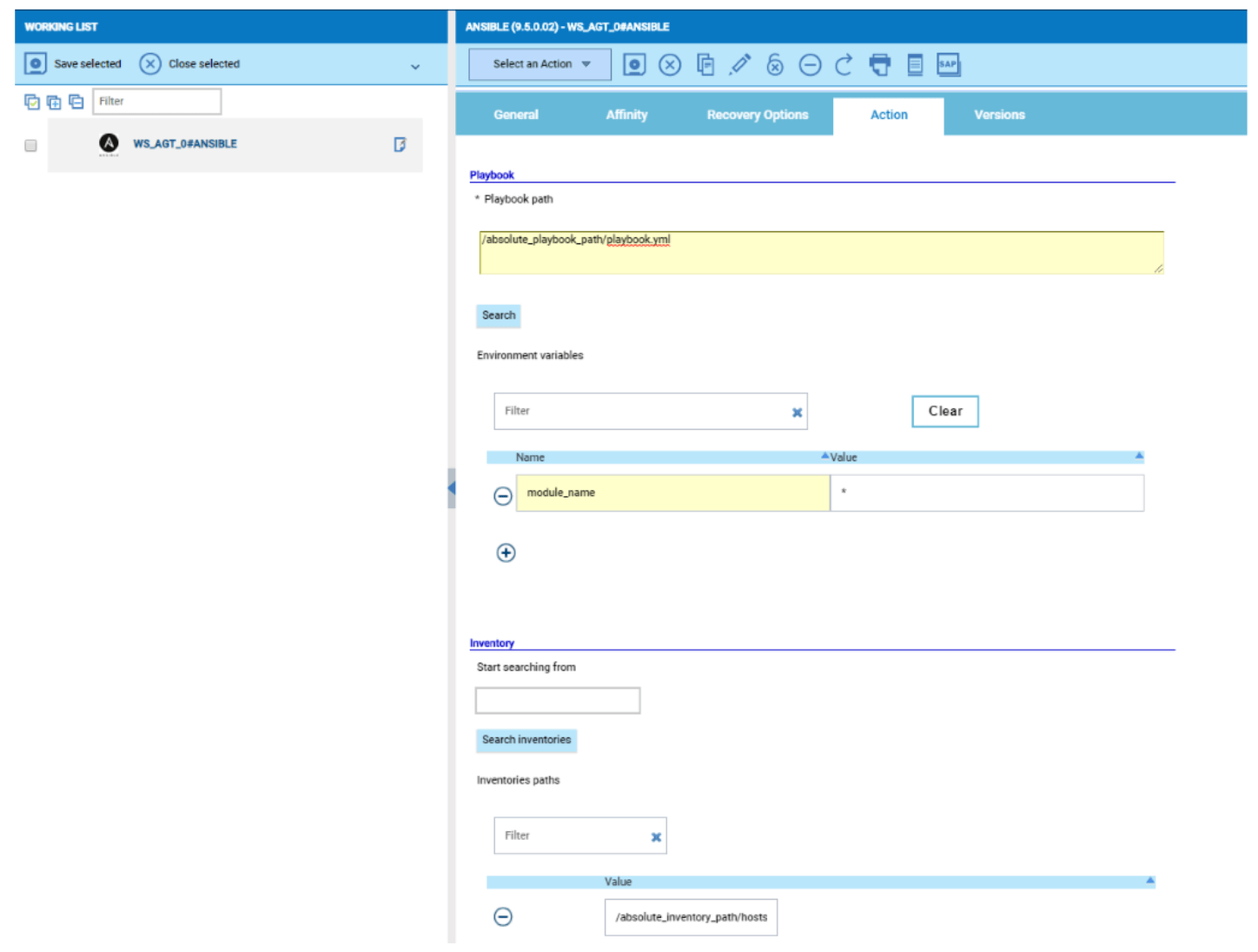

  1. Job definition
job definition
workload automation search form
  • First, we need the code to patch the remote nodes, and usually it is written through a yum module in a yaml file. This kind of file is called playbook.yml, and we can add it by using the playbook path field.  In the field we need to enter the absolute path to the playbook.yml file; we can use the Search button to search such path in the dynamic agent’s file system. The content of the file is the following:
– hosts: all
  tasks:
    – name: Update
      yum:
        name: ” {{ module_name }}
        state: latest
  • Then we need to valorize the variable module_name as an extra argument to correctly execute the playbook. Thus, in the Environment variables section we insert, for example, module_name in the Name column and an asterisk (*) in the Value column.
    The asterisk indicates that Ansible will update all modules found on the target machine.
  • Next, we need to specify the remote nodes to which Ansible should connect. The file with the targets’ list is called inventory and the Inventory section contains the path to such file (or files, since Ansible can consider multiple inventories at once). The Search inventories button allows to search for such paths in the file system of the dynamic agent, starting from the path written just above the button.
    We want to update modules on localhost and on a remote machine, so our inventory file content is as follows:

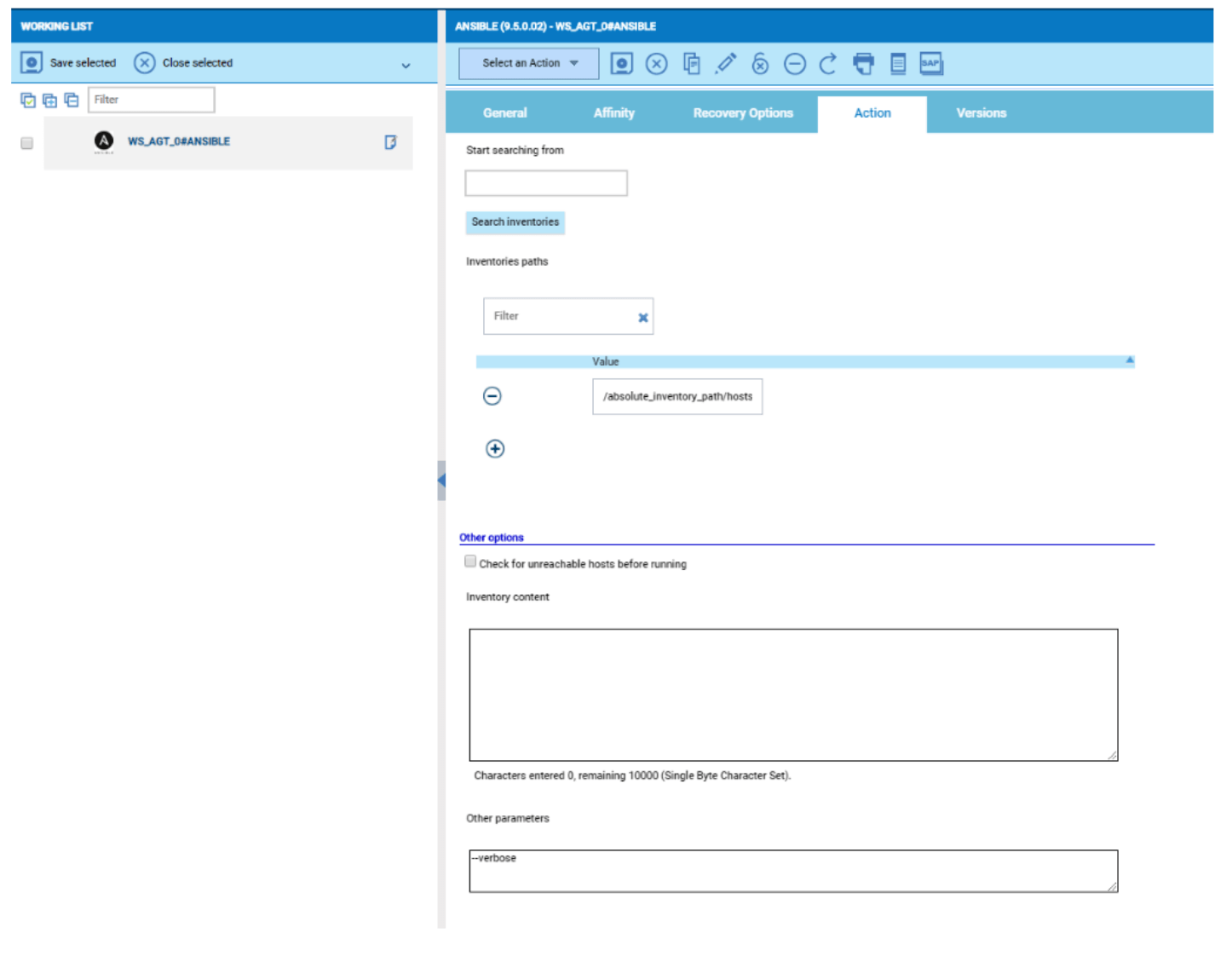

We configured all necessary fields to make Ansible work, but if we want, we can also configure some additional options, such as:
  • Check for unreachable hosts before running: when this option is selected, the plugin forces Ansible to execute the ping module towards all hosts. If at least one host is unreachable, the plugin stops and ends in error showing the list of unreachable hosts. If all hosts are reachable, the playbook execution starts.
  • The Inventory content field gives the possibility to write an inventory directly in the job definition, without the need for a file stored in the file system of the dynamic agent.
  • The ansible-playbook command accepts some additional parameters that can be written in the Other parameters field. For example, the –verbose parameter is used to get a more verbose output.

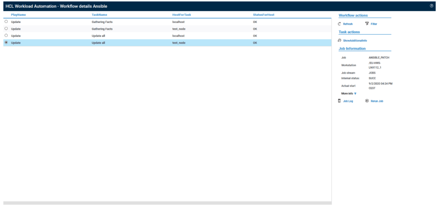

2. Monitoring
workflow details ansible
While Ansible executes the playbook, the plugin offers the possibility to monitor in real-time its execution. Such monitor page, called Workflow details, is accessible from the monitor jobs view and contains details of each task that Ansible has executed up to a particular point. Refresh the page to see the updates and click on the showAdditionalInfo button to get more details about a specific task.
Thus, thanks to the Ansible plug-in, you can automate your playbooks and monitor all your processes running on Ansible, all from one place.
