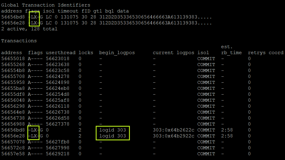

Scenario 2 : Your secondary was stuck in FR mode and Global Transaction cannot be terminated gracefully.
We have two global transactions holding some locks. See onstat -G and onstat -x output below.
3rd flag shows
B- Begin Works
X- TP/XA prepared for commit
How can I get rid of them?
How To Terminate Those Global Transactions
  • Transaction with flags value of ‘-LX-G’ do not have userthread information as in the example above.
  • These transactions are called orphaned transactions, and the user-thread has been dropped from the transaction.
  • If these transactions stop using the Logical Log, they may enter the Long Transaction state.
  • Log switching occurs naturally and causes a long transaction. This depends on the LTXHWM configuration variable setting, which by default is 70.
  • There are 10 Logical Logs, if a transaction is not completed during 7 log switches, a long transaction is usually triggered.
  • You can use onmode -l to manually switch the logical log and exceeds the LTXHWM limit, it will be processed as above. Generally, this does not affect instances or other transactions when processed as above.
  • Alternatively, you would temporarily lower LTXHWM using ‘onmode -wm LTXHWM=<low_value>’.
