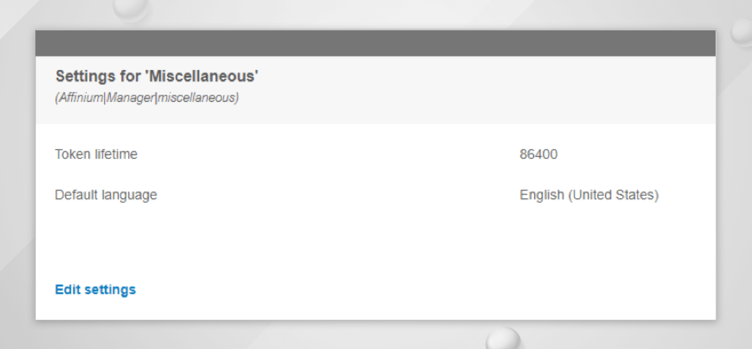

1. Increase a token’s lifetime, which is used for authentication in API calls.
– Navigate to: Affinium|Manager|miscellaneous.
Increase Token Lifetime value as needed. It’s in seconds.

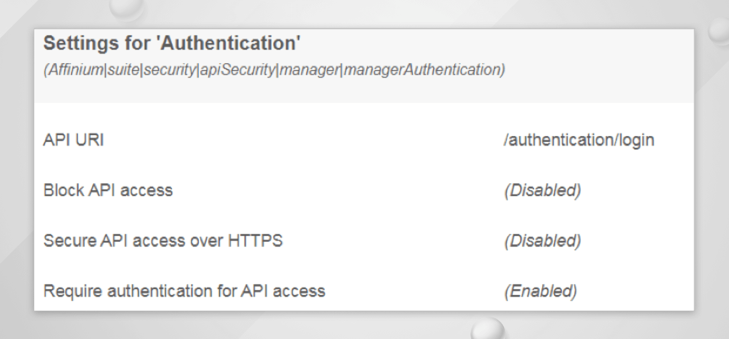

2. Change configurations for API authentication.
– Navigate to Affinium|suite|security|apiSecurity|manager|managerAuthentication
– Disable all properties.
– If you want to keep ‘require authentication for API access’ as true, it will validate the password for users used for API calls.
Assign some password for users from Settings >Users. If it’s disabled, you don’t need to pass any password.
REST API in Campaign- API Authentication

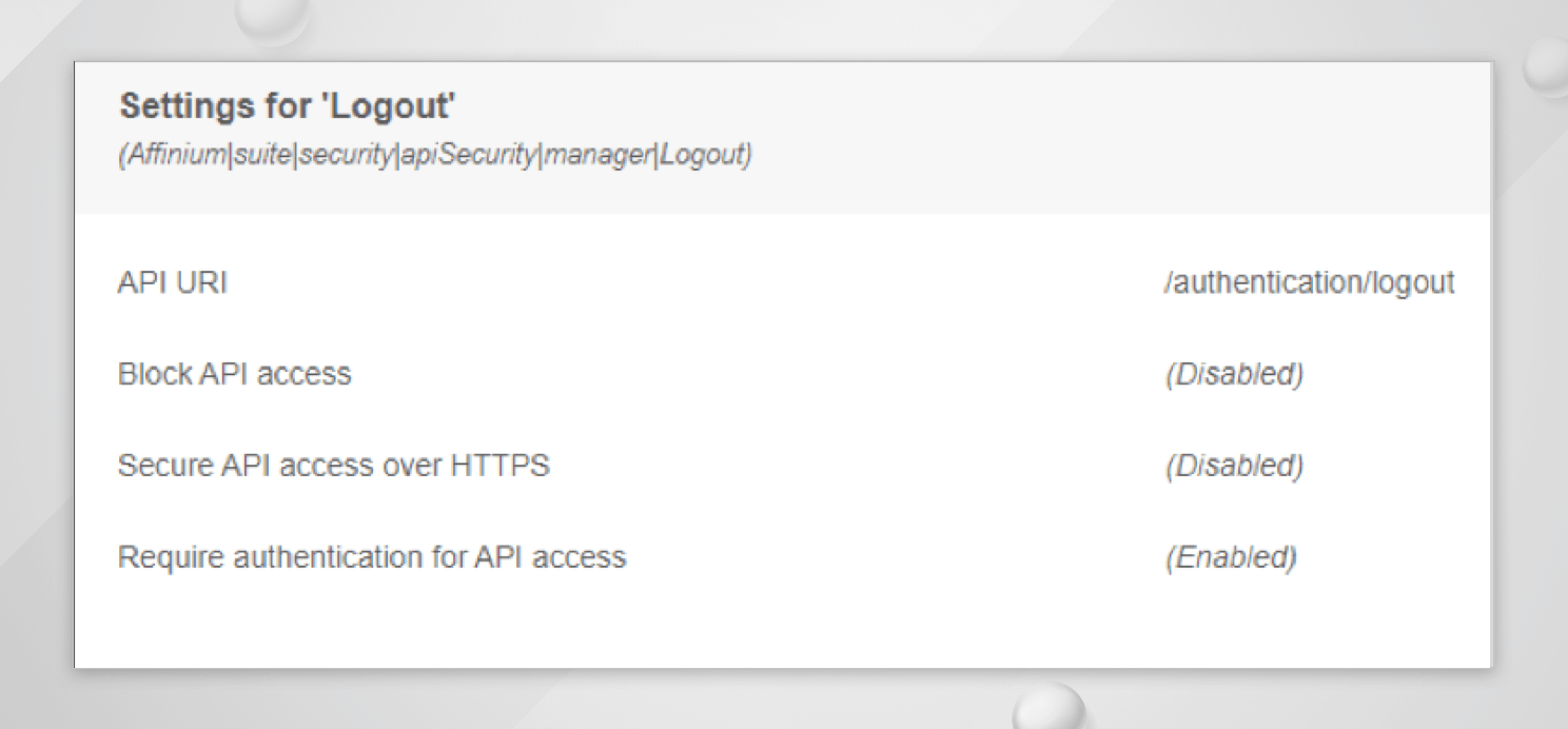

3. Navigate to Affinium|suite|security|apiSecurity|manager|Logout and change configuration value as below.
Campaign-REST API Change Configuration

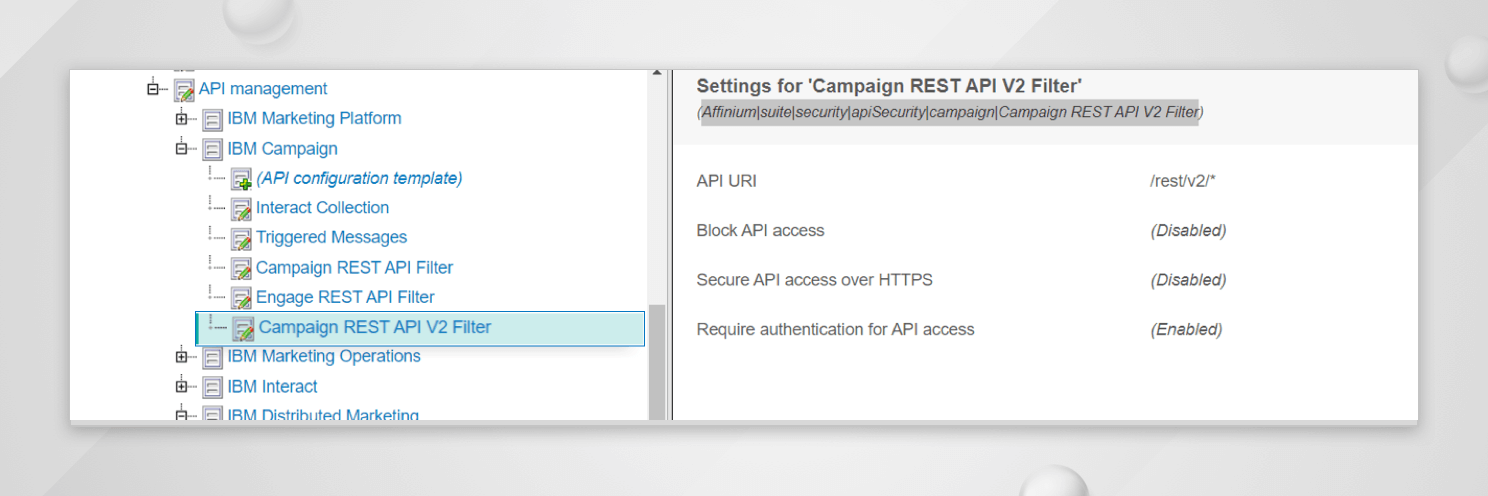

4. Update configurations for Rest API Ver 1.0
Navigate to Affinium|suite|security|apiSecurity|campaign|Campaign REST API V2 Filter.
Update configuration values. Refer to the below screenshot.
– Restart the application server.

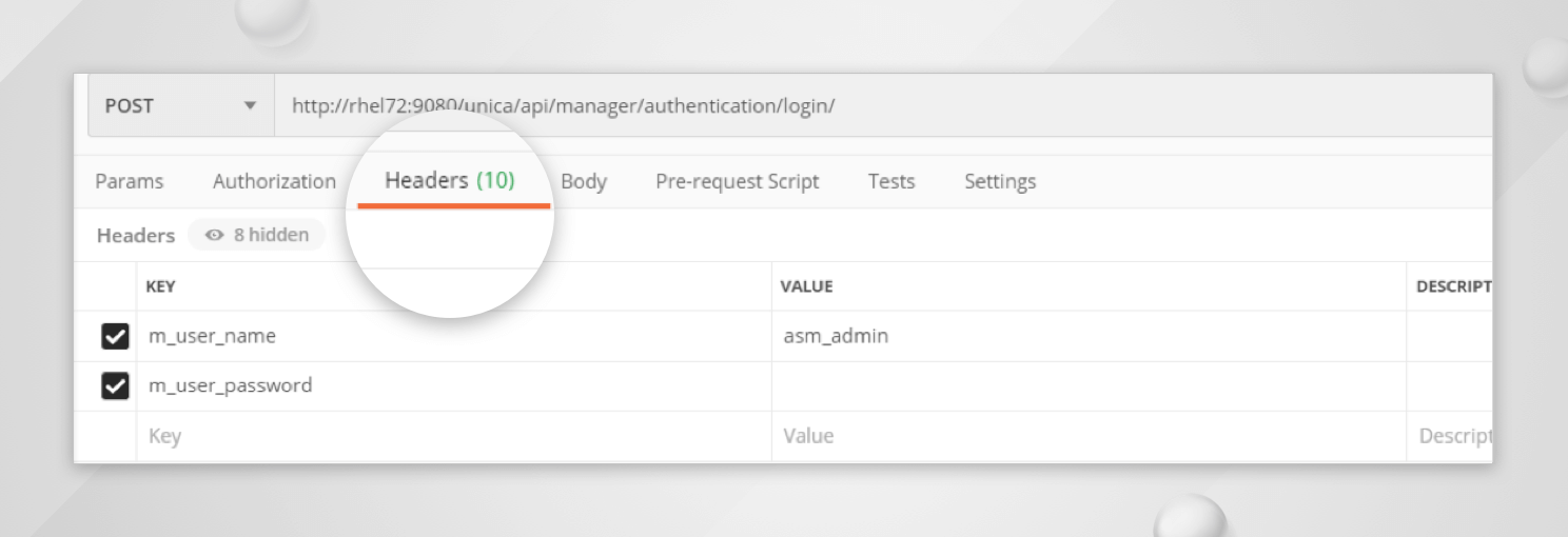

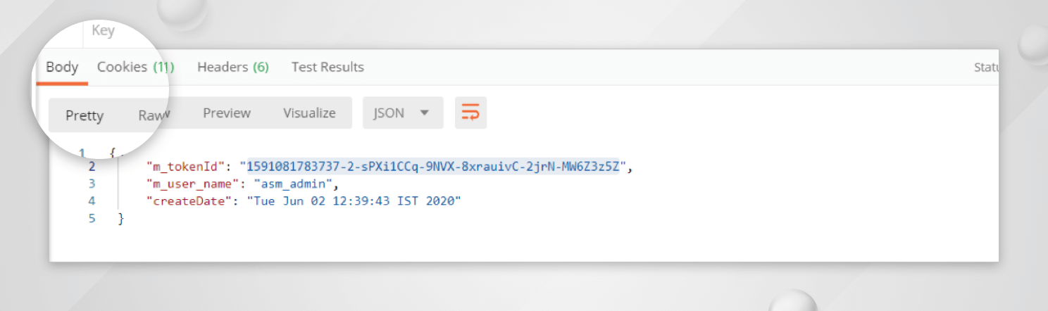

1. Execute POST API call to Platform to get token, which can be used in subsequence API calls for authentication.
Call: POST
URL : https://<HostName:Port>/unica/api/manager/authentication/login/
Headers :
M_user_name > user used for API calls for e.g. asm_admin
M_user_password > password set for user.
Campaign REST API- POST Call
Campaign REST API-Body

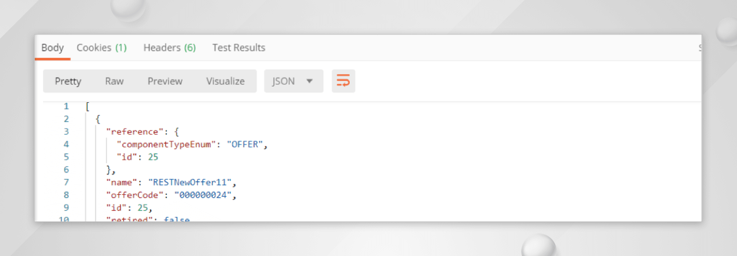

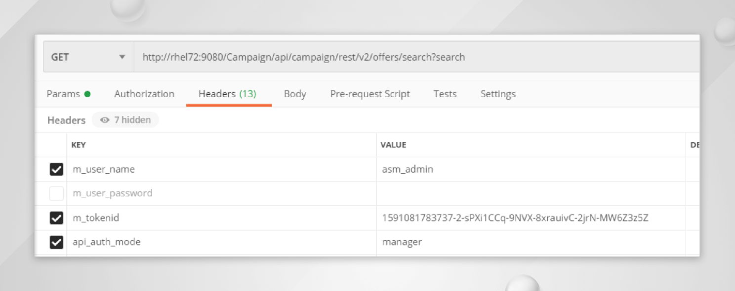

2. You can use this token ID for posting any API calls for Campaign rest APIs. List down offers-
Call: GET
URL : https://<HostName:Port>/ Campaign/api/campaign/rest/v2/offers/search?search
Headers :
m_user_name  > asm_admin
m_tokenid         > <TokenID captured in platform post call>
api_auth_mode > manager
In the ‘search’ string, you can pass any string value to search specific offers.
Campaign REST API-Postman
Campaign REST API- Body

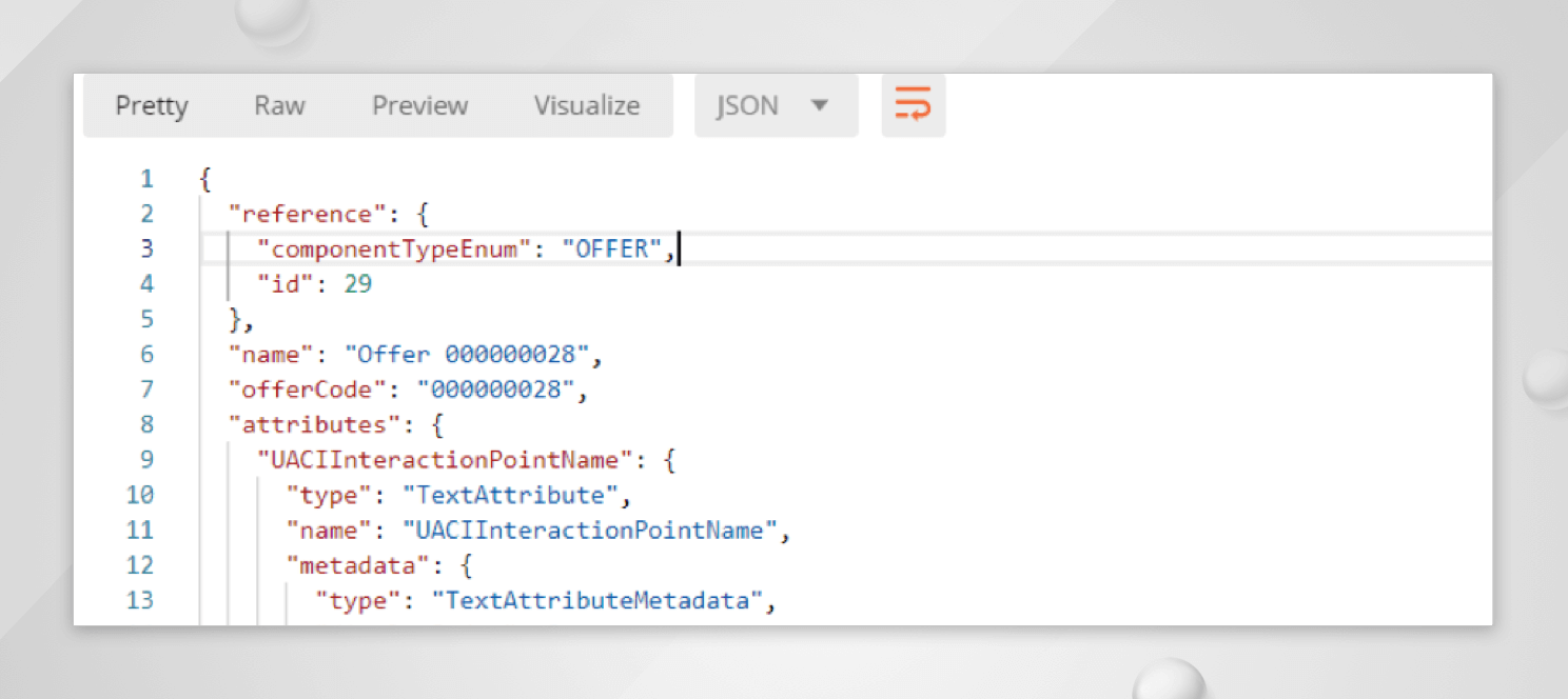

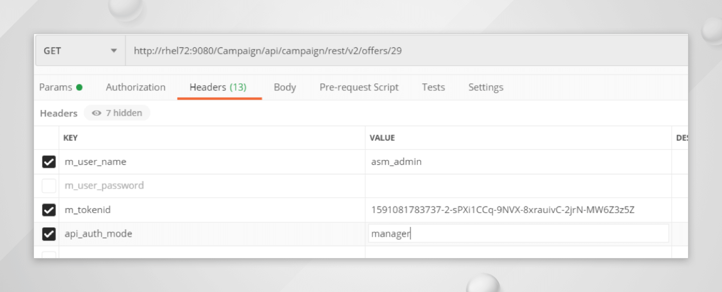

List the particular offer details.
Call: GET
URL : https://<hostname:port>/Campaign/api/campaign/rest/v2/offers/29
Where 29 is offerID . Pass any offer ID for which you need to fetch the details.
Headers :
Campaign REST V2

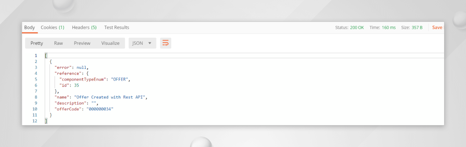

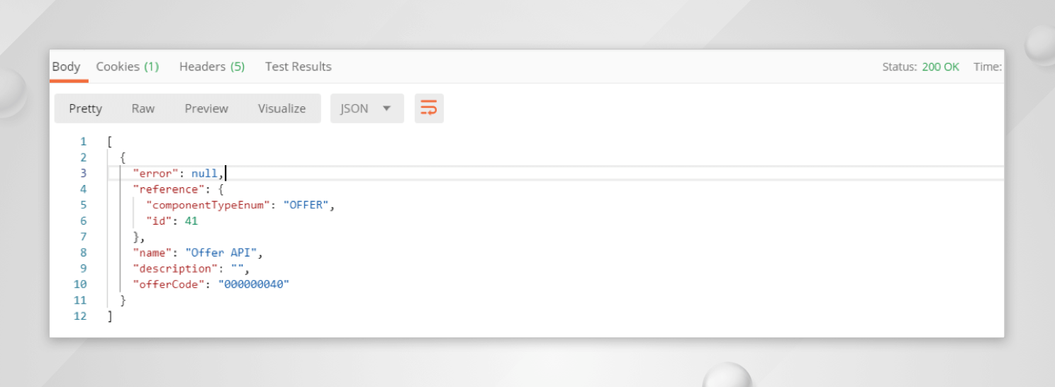

Response :
Campaign REST V2-Response

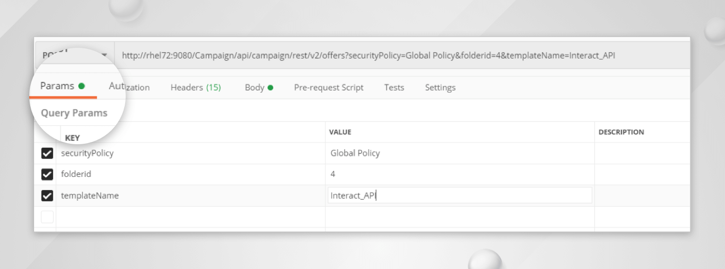

How to create offers in Campaign?

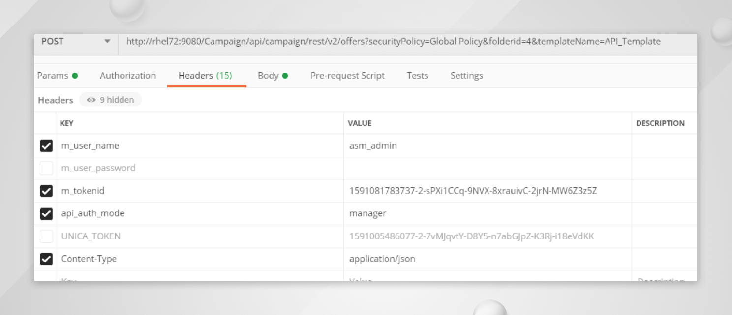

Call: POST
URL : https://<HostName:Port>/Campaign/api/campaign/rest/v2/offers
  • Headers :
    Content-Type > application/json
  • In query parameters, pass below values :
    securityPolicy: Policy name for e.g., ‘Global Policy.’
    folderid: folder ID under which we need to create offers for e.g., 4 [root folder for offers]
    templateName: campaign offerTemplate name from which offers to be created.

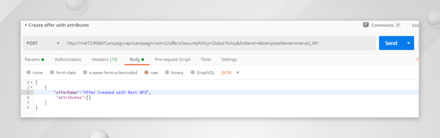

  • Body :
    Select the raw radio button and send JSON body.
    It will have the offer name and parameters. If not, parameters passed; it will create an offer with the default parameter value.
    "offerName":"RESTNewOffer_IP1",
    "attributes":[]
Create offers in campaign
How to create offers in campaign
Create offer with attributes
Create offer with attributes-V2

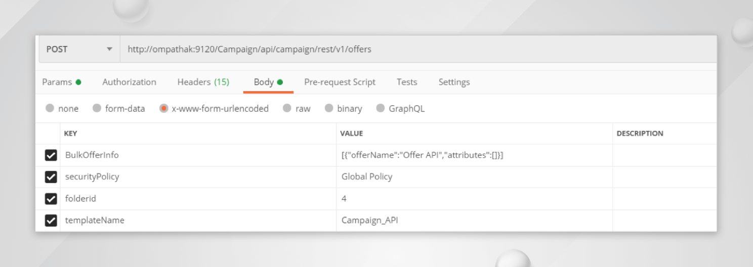

    Call: POST
    URL : https://<HostName:Port>/Campaign/api/campaign/rest/v1/offers
Headers :
You don’t need to add content type, it will be automatically picked up with the input type we are going to select.
On-body section,the select radio button for ‘x-www-form-urlencoded’, pass the below values.
securityPolicy: Policy name for e.g. ‘Global Policy’
folderid: folder ID under which we need to create offers for e.g. 4 [root folder for offers]
templateName: campaign offerTemplate name from which offers to be created .
BulkOfferInfo : [{"offerName":"Offer API","attributes":[]}]
It will have the offer name and parameters. If not parameters passed, it would create an offer with the default parameter value. You can refer below the screenshot for request and response.
Create offer with attributes- REST V1
Create offer with attributes- V1
