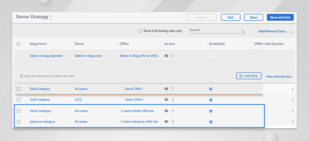

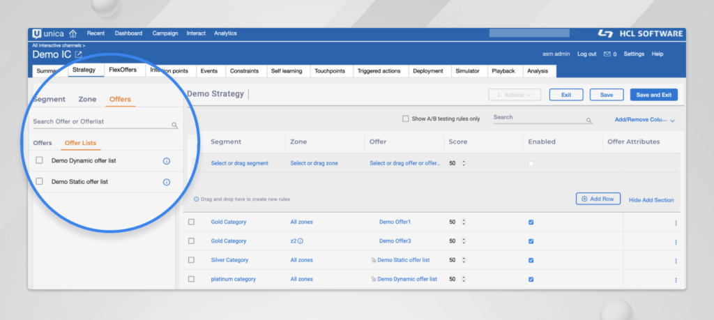

In Interact Strategy Edit mode ‘Offer Lists’ tab is added. To list down Offer lists, click on the icon, and the marketer will get details about the offer list as shown below-
offer list in interact
Once a marketer creates rules using an Offer list, an Icon will be displayed in front of the Offer list’s name to distinguish between Offer and Offer list.

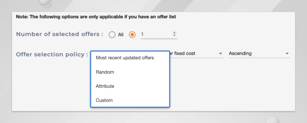

A marketer can select offers from the Offer list by using the following offer selection policies:
  • Most Recent Updated Offers
  • Random
  • Attribute
  • Custom
Enabling Offer List in HCL Unica Interact
Most Recent Updated Offers:
The most recently updated offer will be displayed if the marketer selects this policy.
Random:
If the marketer selects a Random policy, then Offers from the Offer list will be selected randomly.
Attribute:
Offers from the Offer list will be selected based on Attribute and its value in the sorted order.
Custom:
User can create their own Offer Selection policy and then use it in Interact.

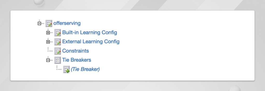

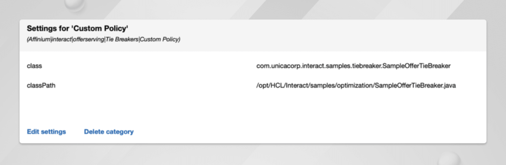

To use Custom Sample policy, the marketer needs to define Custom Class details in the Configuration as below-
In Interact Configuration under offerserving node, click on ‘Tie Break’ node to add details:
1. Add a name for Custom Policy.
2. In class field put ‘com.unicacorp.interact.samples.tiebreaker.SampleOfferTieBreaker’
3. In the classPath field, add a path for the sample java class, including its name.

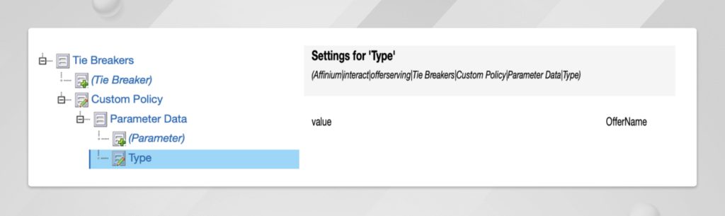

4. To sort Offers based on Offer Name or Offer Code, add Parameter Type under Custom Policy with value OfferName or OfferCode.

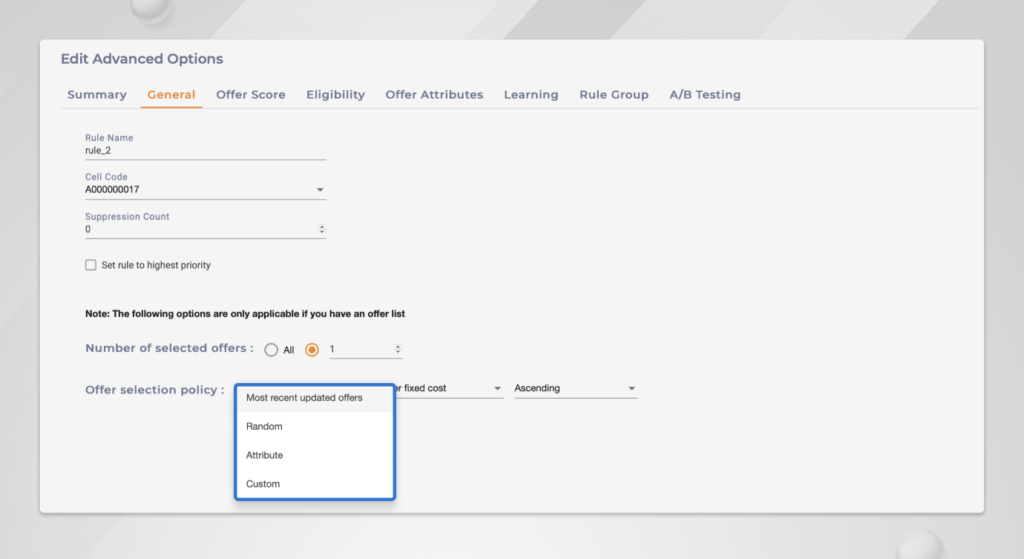

Now to set ‘a number of selected Offers’ from the Offer list and’ Offer Selection policy,’ the marketer can do this from the Rule’s General tab of Advance Option. Offer list options will be displayed for Rules with Offer list only.

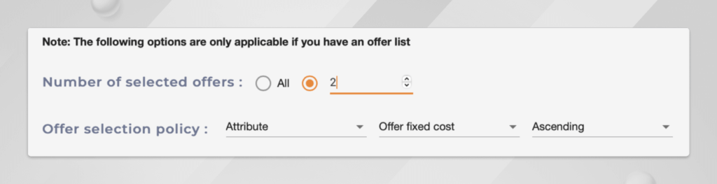

For instance, If a ‘number of Selected Offers’ is set to 2 and for ‘Offer selection policy’ option ‘Offer fixed cost’ attribute is selected, then in this case Offers will be sorted in ascending order of ‘Offer fixed cost’ Attribute value and top 2 Offers will be selected.
