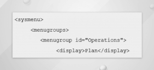

4. In Plan_HOME/conf/xx_XX/sysmenu.xml (where xx_XX is the locale) change the value of <display> to Plan.

6. In Plan_HOME/conf/en_US/sysmodules.xml (where en_US is the locale), change the value of <display> to Plan.
