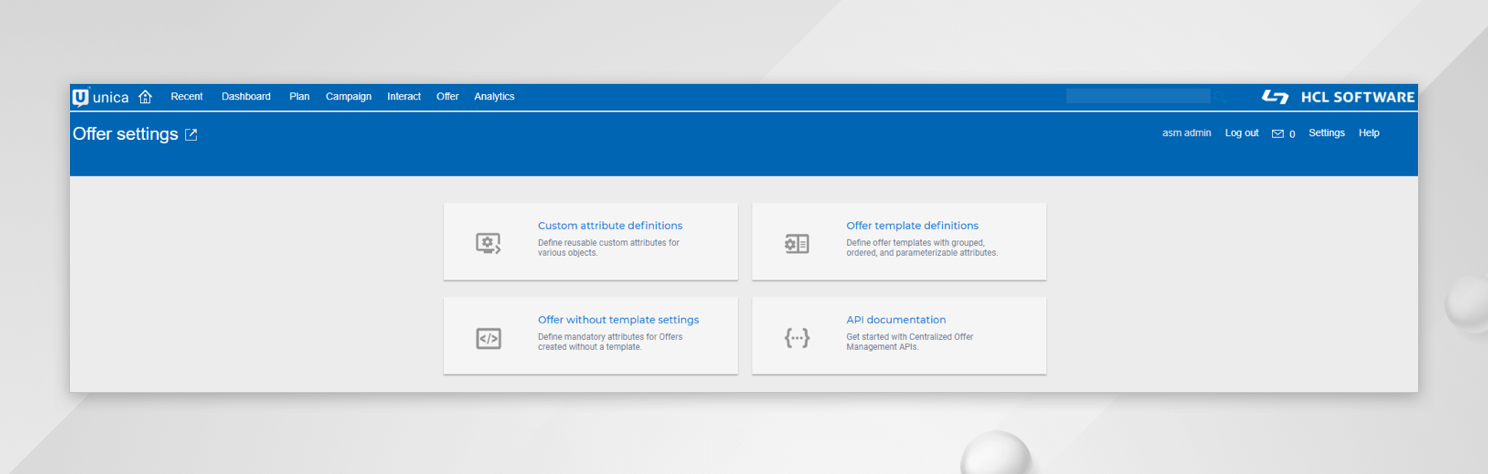

Offer attribute creation
To create an offer attribute, you need to navigate Setting Offer settings and then click on ‘Custom attribute definitions.’ On this page, you have a button ‘Add custom attribute’ to add a new attribute. You can fill the necessary details below to create a new custom attribute for the Offer.

Offer template creation
To create an offer template, navigate to Setting Offer settings, and click on ‘Offer template definitions.’ On this page, you have the ‘Add new template’ button to create a new offer template. On the ‘Metadata’ page, provide the necessary details, and then click on ‘Next.’
