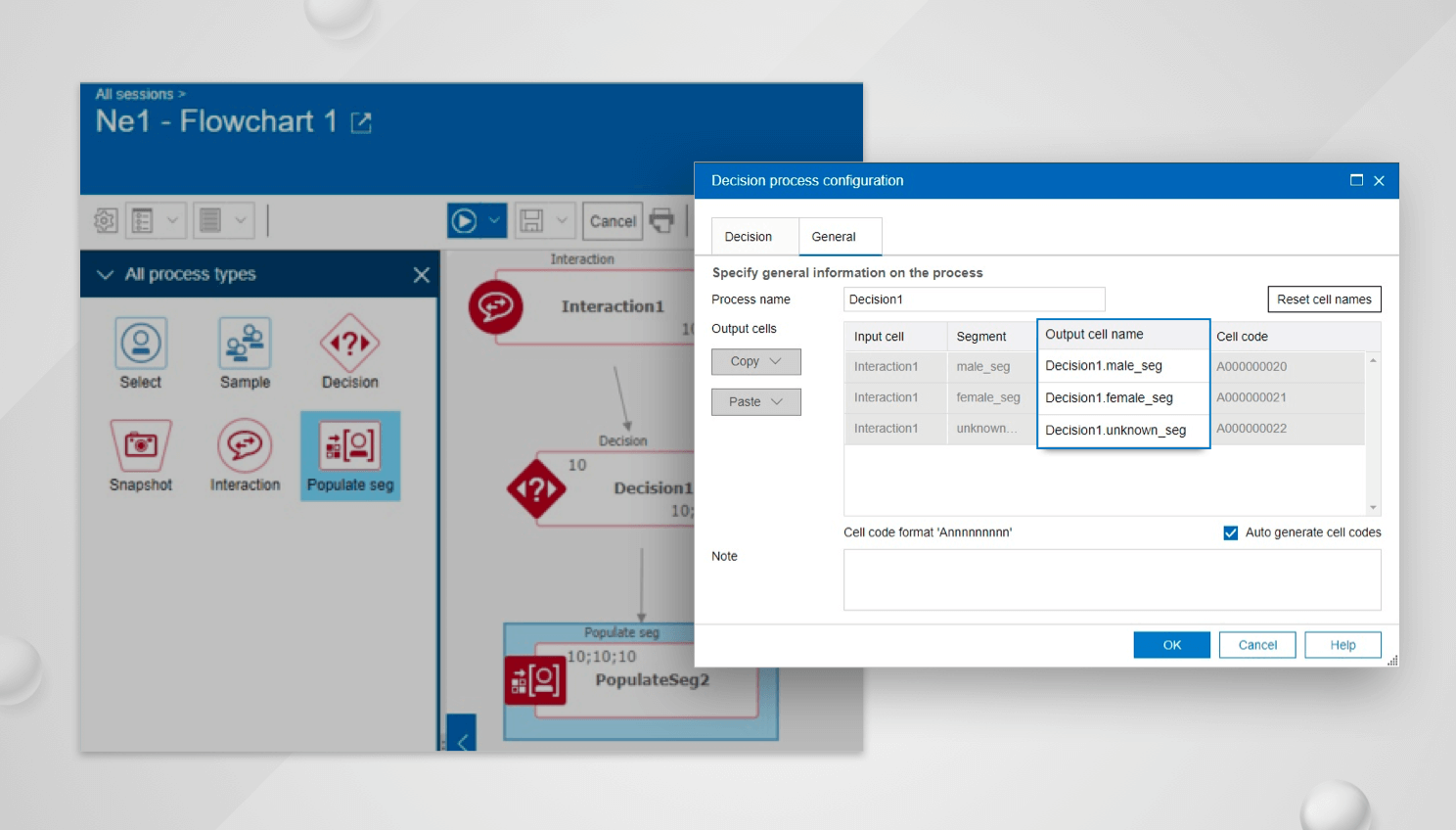

While running a test run, sometimes, the user will not seek to view all 1000 records. For such scenarios, he can limit the output to 15 records  (like in the image below).

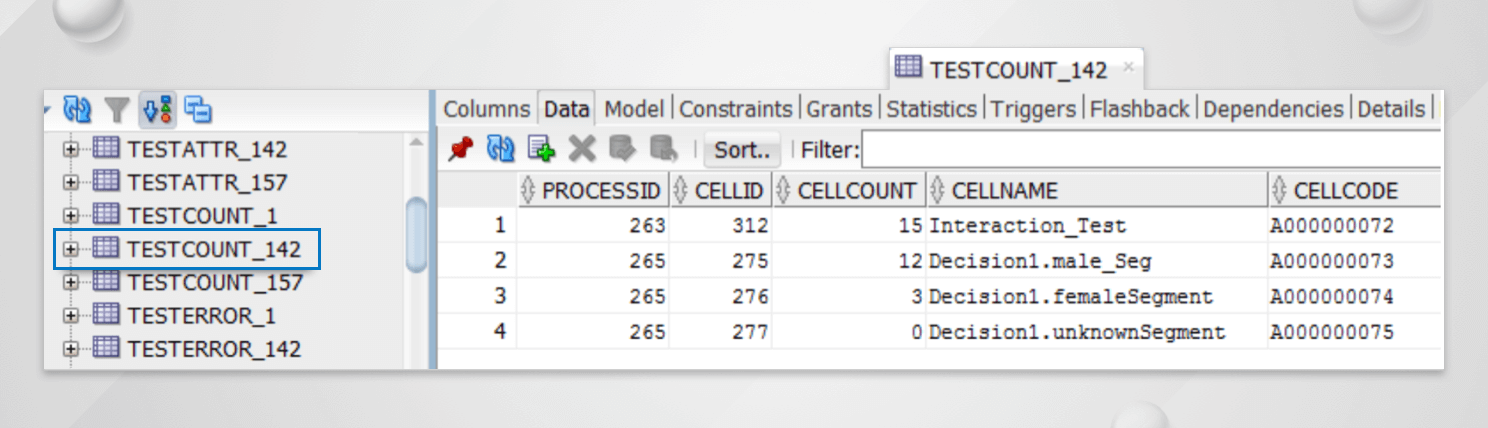

  • How to use the TESTCOUNT_n table?
How many process boxes were involved in the flow chart configuration? Which process system failed and under which cell code? All such information is stored under TESTCOUNT_n. It is created under the profile database per interactive flowchart. The table has 5 columns. PROCESSID, CELLID, CELLCOUNT, CELLNAME, CELLCODE.
Unica Interact Flowchart
PROCESSID: The column contains the ID (Numeric data) for each process box taken into the Interactive Flowchart
CELLID : Different process boxes like Decision, Sample processes can create multiple cells from it. This column contains the IDs for each of the cells created from the Interactive Flowchart. Interaction Process, Select Process can create a maximum of one output cell. Sample Process, Decision Process, can create one or more output cells. Snapshot Process and Populate Seg Process do not contain any of the output cells.
CELLCOUNT: This column contains the count in each of the cell populated when the test run of the Interactive flowchart is done.

CELLNAME: This column contains the name of each output cell created in the Interactive flowchart after it is test run. OutPut cell names are created in the Processes box.

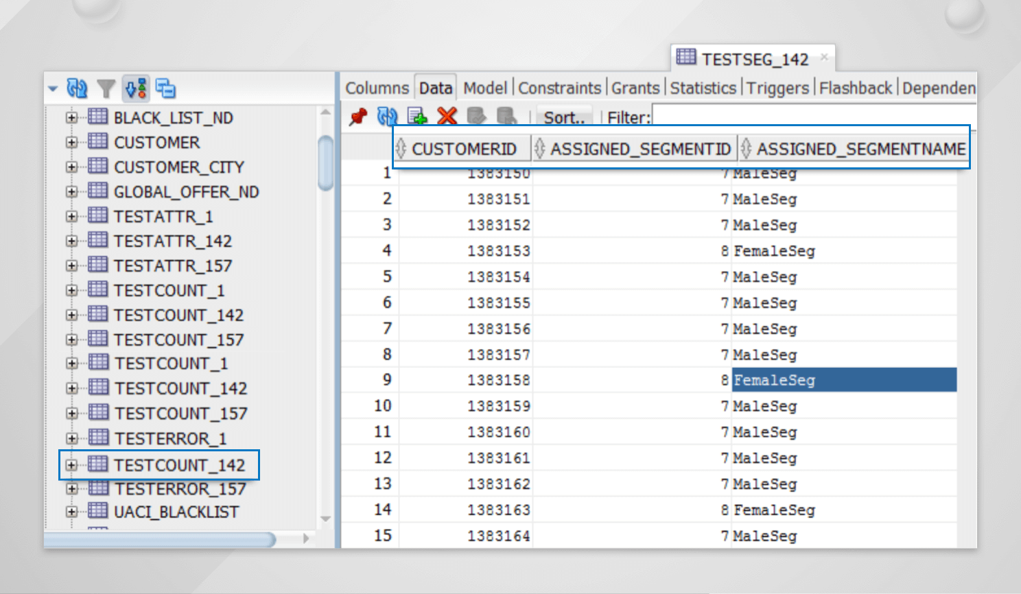

  • How to use the TESTSEG_n table?
The flowchart creates segments. In the present case, the segment is divided into 2 groups- Male Segments & Female Segments. So which audienceID belongs to which segment? The information gets stored in TESTSEG_n. The table has the following columns – AUDIENCEID, ASSIGNED_SEGMENTID, ASSIGNED_SEGMENTNAME.
AUDIENCEID: If the data contains CustomerID as the audienceID,  the name of the column will be CUSTOMERID. Its datatype will be dependent on the data type of the audienceID created in the HCL Campaign.
ASSIGNED_SEGMENTID: The column contains the IDs of the Smart Strategic Segment in which the audience ID falls.
ASSIGNED_SEGMENTNAME: The column contains the NAME of the Smart Strategic Segment in which the audience ID falls. In case, if the audienceID does not fall in any of the Smart Strategic Segment, then the value next to the audienceID remains NULL.

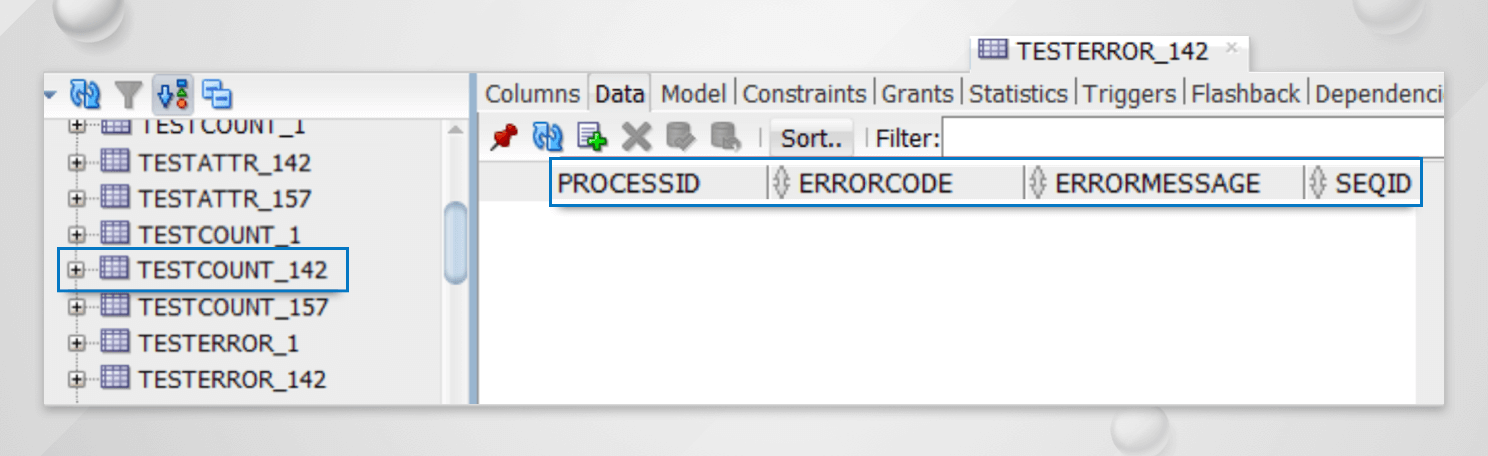

So, what is the error message with which my flowchart failed? The information on all error messages gets stored in the table TESTERROR_n.
  • How to use the TESTERROR_n table?
If the test run of the interactive flowchart fails with some error message, then the respective ERRORMESSAGE, ERRORCODE, and the ID of the processes box which fails are inserted into this table.
PROCESSESID: This column has a numeric data type. It contains the ID of the processes box, which failed to run in the Interactive Flowchart.
ERRORCODE: This column contains the Error code by which the Processes box in the interactive flowchart failed to run.
ERRORMESSAGE: This column contains the description of the Error message, describing the reason by which the Processes box in the interactive flowchart failed to run.
SEQID: This is a system-generated unique field for each record inserted into the table.
