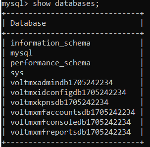

In the following screenshot note the Database Name Suffix field. Foundry has six databases that contain configuration and application information. Each of these databases have this string added to the end of its name. When upgrading to a new version of Foundry, you will need to provide this string
For example, using mySQL command “show databases;” was issued and returned the following. The Foundry databases begin with Volt MX.
