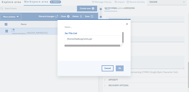

Specify the Home Directory of the Hadoop Filesystem , in this case it is /home/hadoop/hadoop-3.3.1 which is the Home path that includes bin directory (two steps behind hadoop binary):
hadoop map reduceSelect the hadoop Jar file comprising of all Classes of the packaged application from the specific location : in this case /home/Hadoop/units.jar :
jar file list

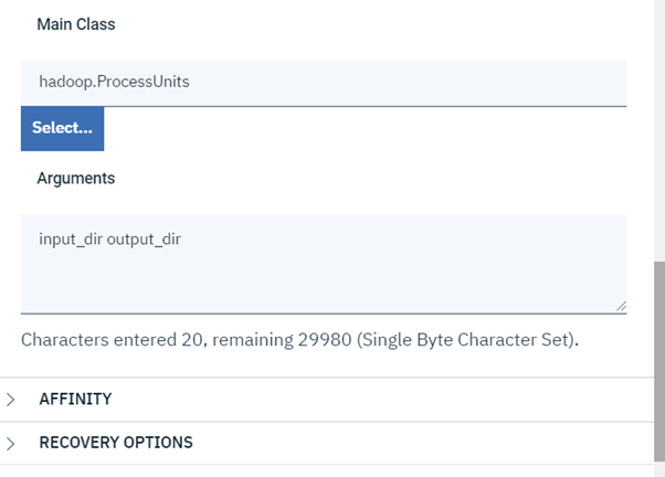

Also, Enter the Main Class to be executed, in this case it is hadoop.ProcessUnits :
All Arguments to be passed to Hadoop Map Reduce Program as input such input_dir where all input files for the Hadoop Map Reduce program are present and output_dir for the Output is mentioned under Arguments section :
hadoop process units
