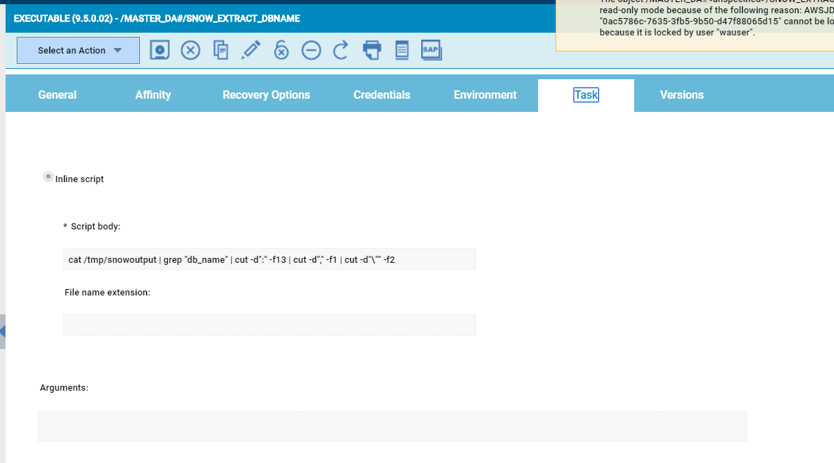

SNOW_EXTRACT_DBNAME Job :
The job SNOW_EXTRACT_DBNAME would extract the DB Name from the JSON output within /tmp/snowoutput.

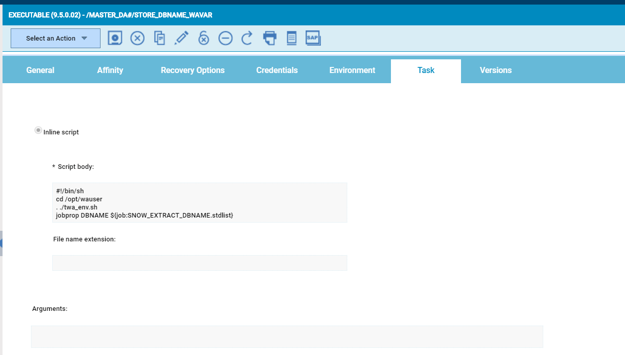

STORE_DBNAME_WAVAR Job :
The job STORE_DBNAME_WAVAR fetches the joblog output of SNOW_EXTRACT_DBNAME and stores it in a Variable called DBNAME through jobprop utility of HWA:

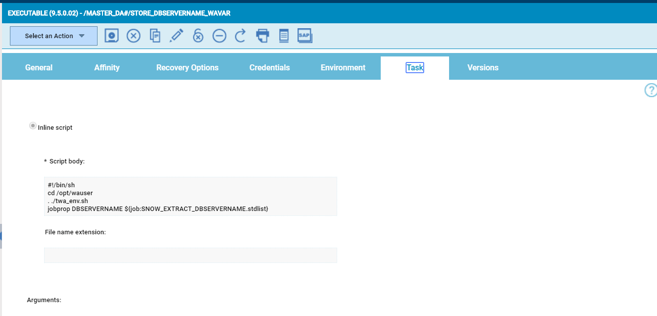

STORE_DBSERVERNAME_WAVAR Job :
The job STORE_DBSERVERNAME_WAVAR fetches the joblog output of SNOW_EXTRACT_DBSERVERNAME and stores it in a Variable called DBSERVERNAME through jobprop utility of HWA:
Case Study: Service Now RM Orchestration through HWA
Fig 9

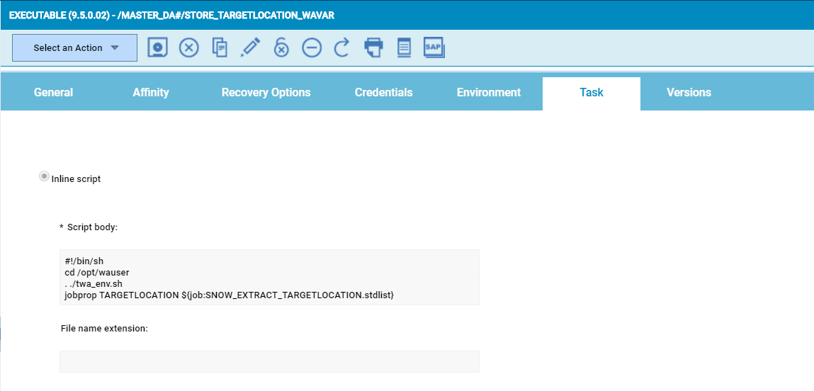

STORE_TARGETLOCATION_WAVAR Job :
The job STORE_TARGETLOCATION_WAVAR fetches the Joblog of SNOW_EXTRACT_TARGETLOCATION job and stores it in a variable called TARGETLOCATION using jobprop utility:

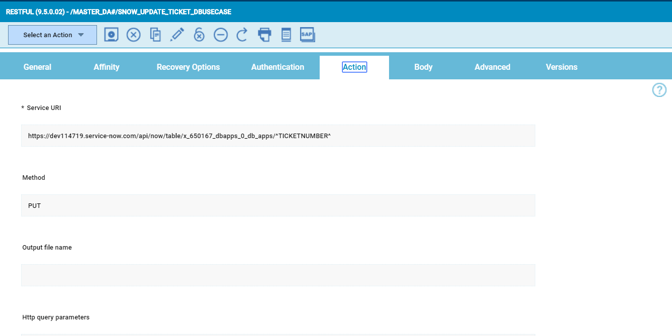

SNOW_UPDATE_TICKET_DBUSECASE job :
The SNOW_UPDATE_TICKET_DBUSECASE job is a RESTFUL Put job that updates the specific Ticket in Service Now to indicate that the Backup was Successful. The job picks the variable from variable table SNOW_DB_USECASE:

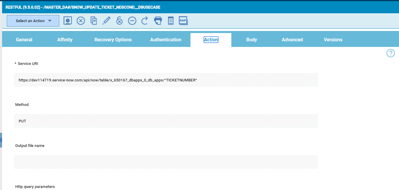

SNOW_UPDATE_TICKET_NEGCOND__DBUSECASE Job :
The job SNOW_UPDATE_TICKET_NEGCOND__DBUSECASE is setup to Update the Ticket incases when Backup Fails, this is a RESTFUL Put job which would pick the Ticket Number in question and update the Ticket to indicate that the Backup Failed. This job would act as a Conditional Successor of the DBBACKUP job and would only run when it Abends:
