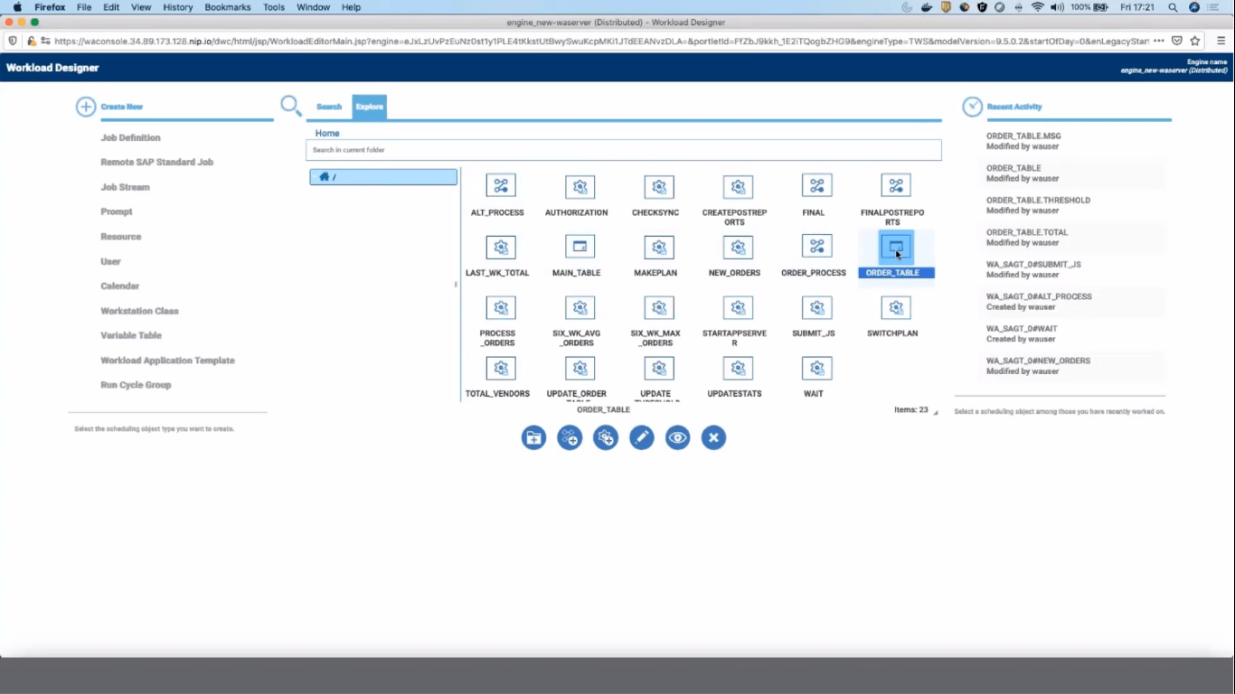

Access again the workload designer and open the order_table object.
workload designer
Fig 17: Workload Designer
Verify that the message is updated and  Switch to the order_process job stream.
