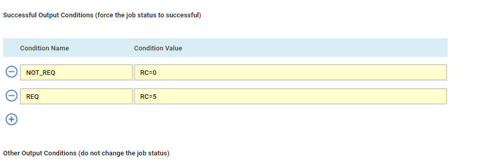

This is realized as Unix Job to check if a claim escalation is needed in this case, so the script called evaluates if the value returned is beyond a particular value:
There would be conditional dependencies defined where every Return Code is mapped to “REQ”, “NOT_REQ”. So, depending on the Return Code 5 or 0, the corresponding conditions are passed that is Required and Not Required.
In case escalation is required, SEND_CLAIM_ESCALATION_PORTAL job is called to do a RESTFUL POST job into the Portal such that the Claim is escalated for further approvals to higher Management in case the amount is beyond a particular value.
