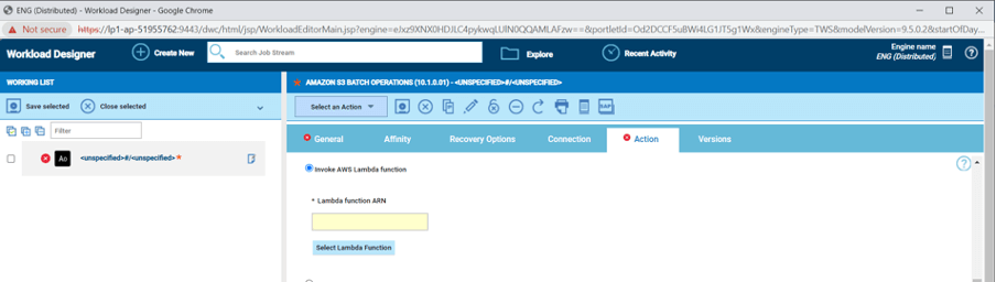

  • Invoke AWS Lambda function:
    Use this operation to invoke the selected lambda function on the objects specified on the manifest file.
Invoke AWS Lambda Function section
Figure 5: Action Page > Invoke AWS Lambda Function section

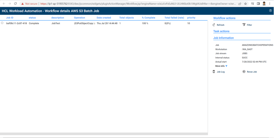

Monitoring your job:
While Amazon S3 Batch Operations executes the process, the plug-in offers the possibility to monitor real-time the execution. Such monitor page, called Workflow details, is accessible from the monitor jobs view and contains all details about the job. Refresh the page to see the updates.
Workflow Details Page
Figure 9: Workflow Details Page
