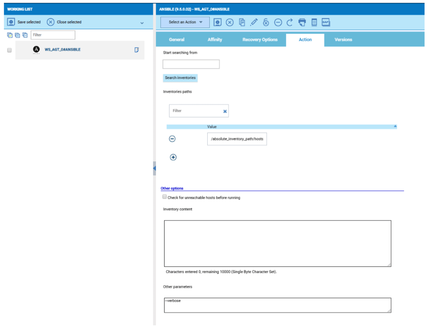

- Next, we need to specify the remote nodes to which Ansible should connect. The file with the targets’ list is called inventory and the Inventory section contains the path to such file (or files, since Ansible can consider multiple inventories at once). The Search inventories button allows to search for such paths in the file system of the dynamic agent, starting from the path written just above the button.
We want to update modules on localhost and on a remote machine, so our inventory file content is as follows:
[LOCAL]
localhost ansible_connection=local
[REMOTE]
node_name ansible_ssh_user=<username> ansible_ssh_host=<ip>
We configured all necessary fields to make Ansible work, but if we want, we can also configure some additional options, such as:
- Check for unreachable hosts before running: when this option is selected, the plug–in forces Ansible to execute the ping module towards all hosts. If at least one host is unreachable, the plug–in stops and ends in error showing the list of unreachable hosts. If all hosts are reachable, the playbook execution starts.
- The Inventory content field gives the possibility to write an inventory directly in the job definition, without the need for a file stored in the file system of the dynamic agent.
- The ansible-playbook command accepts some additional parameters that can be written in the Other parameters field. For example, the –verbose parameter is used to get a more verbose output.
