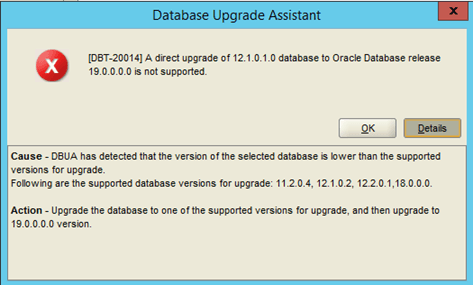

  1. Make sure that your current version of Oracle 12c is supported, before upgrading to Oracle 19c
enforce the database instance of Workload Automation

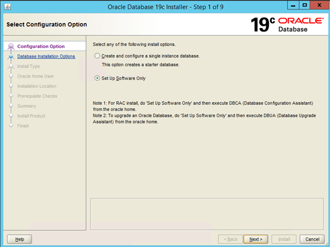

a. Choose the “Set up Software Only” option and click Next

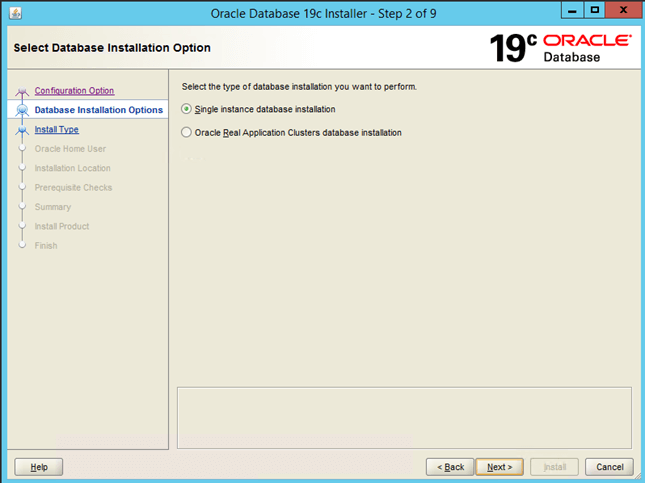

b. Choose the “Single instance database installation” option and click Next

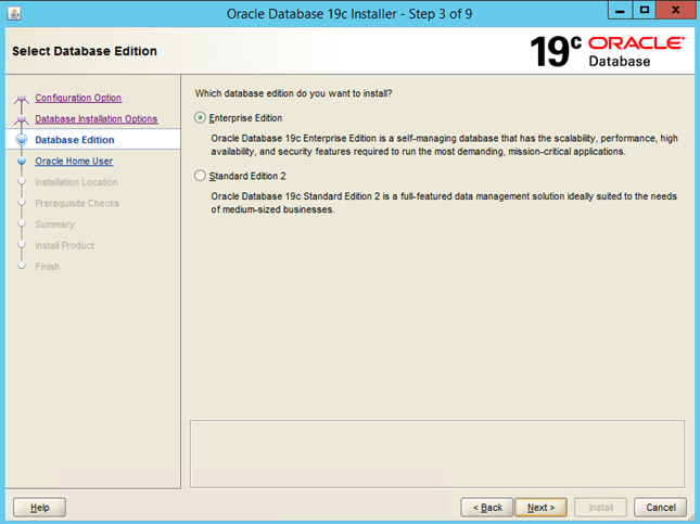

c. Choose the “Enterprise Edition” option and click Next

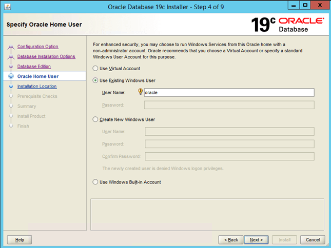

d. Choose the “Use Existing Windows User”, fill with the User Name and click Next

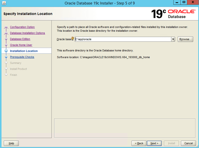

e. Specify a path for the Oracle base directory, click Next and proceed to install the Product

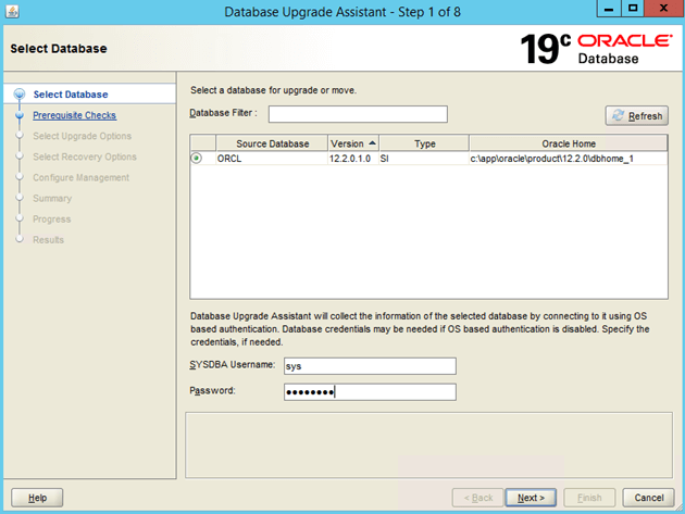

3. After the installation, launch C:\images\ORACLE19c\WINDOWS.X64_193000_db_home\bin\dbua.bat to upgrade Oracle 12c instance to the new version:
a. Insert the SYSDBA Username and Password and click Next

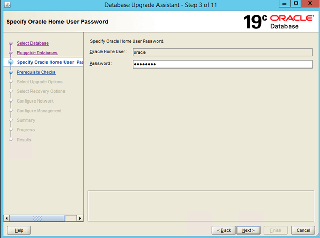

b. Insert the Oracle Home User and Password and click Next

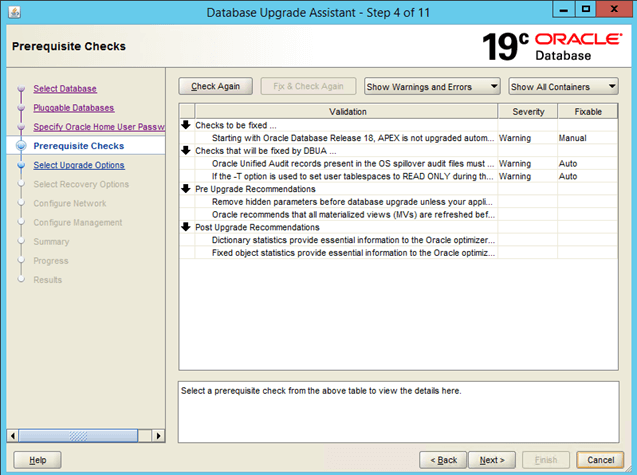

c. Fix all warnings

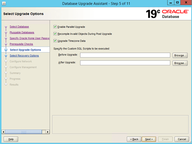

d. Check the options “Enable Parallel Upgrade“, Recompile Invalid Objects During Post Upgrade andUpgrade Timezone Data” and click Next

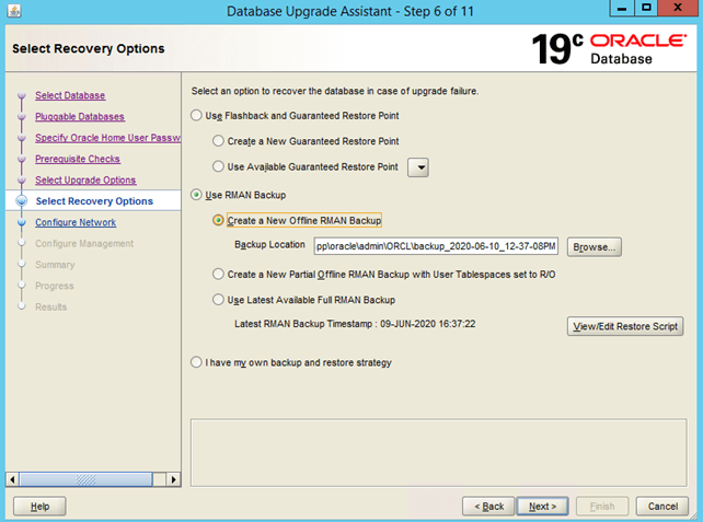

e. Choose the “Create a New Offline RMAN Backup” option and browse a backup location, then click Next

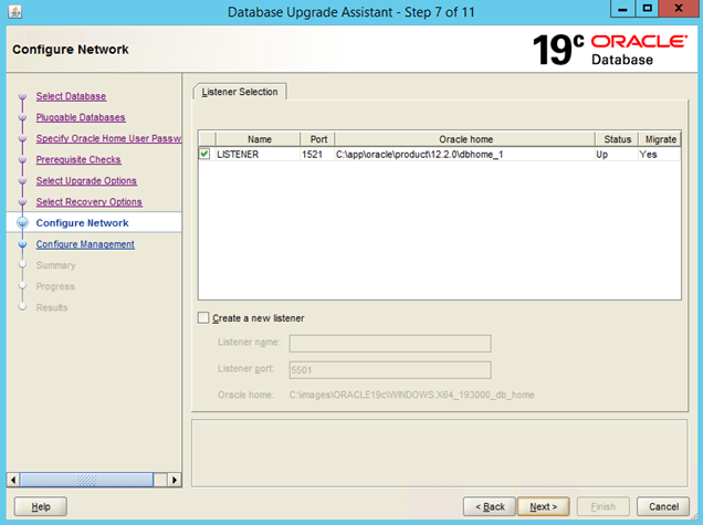

f. Check the Listener retrieved and click Next

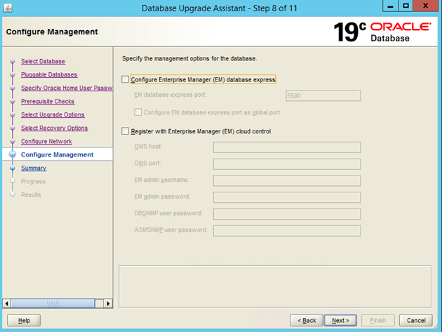

g. Specify Configure Management if needed and proceed

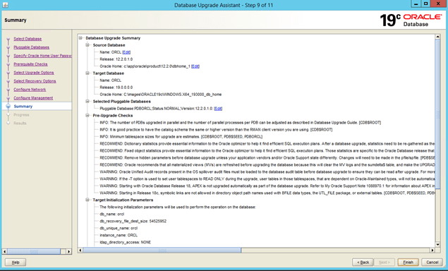

h. Click Finish to upgrade and Close

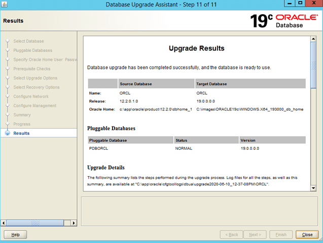

At the end of the upgrade, you can see:

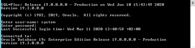

And from the Oracle command line, you can check the successfully upgrade action:
