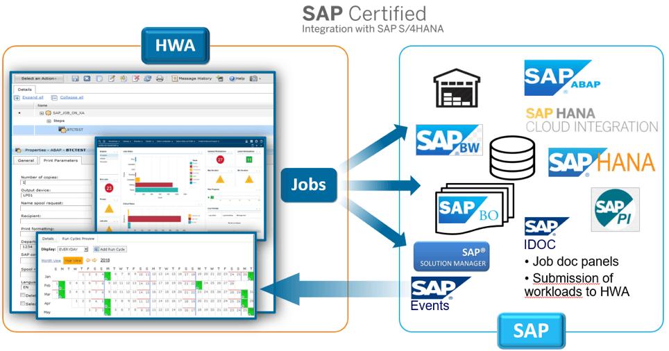

Using Workload Automation integrated with SAP®, you can create, schedule, and control SAP jobs and monitoring you SAP landscape.
SAP jobs run on application servers that host work processes of type batch. Critical batch jobs are run in specific time frames, on specific application servers. With SAP Basis version 6.10 and later, application servers can be assigned to server groups. With Workload Automation, you can assign a server group to a job and leveraging the Job Throttling feature it can manages all SAP background processes from several applications on one or more servers in heterogeneous environments. In this way, when a job is launched, the SAP system runs it on an application server that belongs to the specified group, balancing the workload among the various application servers.

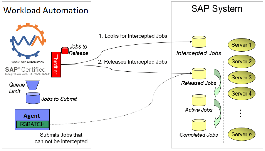

The Job Throttling feature helps you to improve the efficiency of your scheduling on SAP systems and reduces the batch window for your SAP jobs to a minimum. Using advanced XBP 2.0 and 3.0 functions, such as the job interception and parent-child, the job throttling ensures that the SAP system is not overloaded and the number of released jobs does not exceed the total number of free SAP background work processes in the system.

Workload Automation launches jobs in SAP using jobs defined to run on a dedicated agent. An SAP extended agent or dynamic workstation is defined as a Workload Automation workstation that is hosted by a fault-tolerant agent, master workstation or broker, which uses the r3batch access method. The SAP agent workstation uses the access method r3batch to pass SAP job-specific information to predefined SAP instances.
If you need to run hundreds of jobs daily you need to keep the jobs from killing the other systems, so a mechanism should be put in place to disallow running at the same time more than a defined number of jobs of certain types on certain environments. This is called a “throttling” mechanism and it allows an administrator to control the flow of jobs through the system. These throttling policies work as filters allowing or disallowing a job to be considered for scheduling by specifying limits regarding system usage for any given moment.
On SAP system, when the number of released batch jobs exceeds the number of background work processes, the SAP system gets overloaded and reduces the overall execution responsiveness.
The Workload Automation Job Throttling feature queues intercepted jobs and releases them when the background work processes that they need on the SAP server or SAP server group are available. The queue of intercepted jobs is sorted by scheduling time and priority of SAP jobs. When the SAP parent-child feature is enabled, children jobs inherit their parent’s priority so that new urgent jobs are run before other planned jobs.

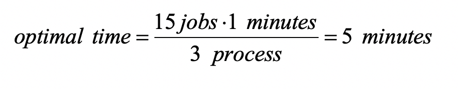

Scenario 1 – Performance Comparison
Environment
  • SAP System with 3 Background process.
  • A parent job that spawns 15 children jobs.
  • Each children job runs for 1 minutes.
performance comparison
Scenario
  • Inspection of Job Interception table see that INTER* jobs are intercepted.
  • Submission of a parent job that submits not intercepted children.
  • Submission of a parent job that submits intercepted children.
  • Comparison between intercepted and not intercepted children total time.

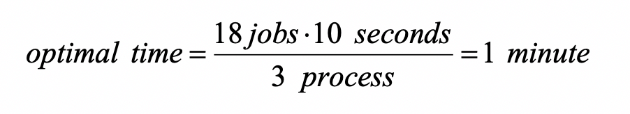

Scenario 2 – Another Priority Inheritance
Environment
  • A class ‘A’ parent job that spawns 9 children jobs.
  • A class ‘B’ parent job that spawns 9 children jobs.
  • Each children job runs for 10 seconds.
another priority inheritance
Scenario
  • Submission of both class ‘A’ and ‘B’ parent jobs without the throttler:
    • No order for child execution
    • Daly in overall execution time
  • Submission of both class ‘A’ and ‘B’ parent jobs with the throttler.
    • Class ‘A’ job’s children are executed before class ‘b’ ones.
    • No delay in overall execution time
