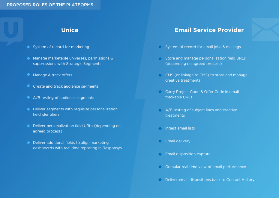

This answers the first question about how to integrate Unica with a new ESP. As I mentioned above, the second question, “what to do where” is a little challenging to answer. That said, I always default to the “DNA” test as a starting point.
Diagram 3 below shows some thoughts on what is core to the DNA of each platform.
The core DNA of the platforms
Things like a system of record data across all channels, audience management, and sophisticated segmentation are core to the DNA of Unica. Deliverability, management of personalization, email content management, and creative testing are in the core DNA of most ESPs.
